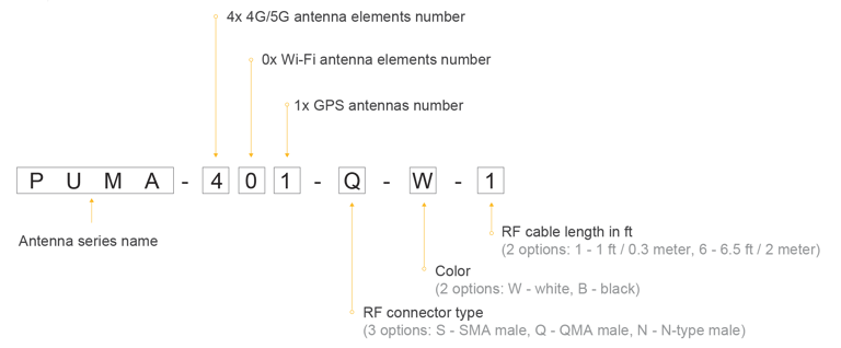

    Q. What does each letter/ number on Peplink Mobility series on the SKU numbering stand for?
    Each number and letter after the series name, has its own meaning and purpose. Here’s what it stands for:
      ⚬ The first number represents the number of LTE element
      ⚬ The second represents the number of  Wi-Fi element
      ⚬ The third  represents the number of  GPS element
    The next letter in the SKU numbering represents the RF connector type, there are 2 options for this: S-SMA male; Q- QMA male.
    The letter following this will simply represent the colour of the model: B- Black; W- White.
    The final number will represent RF cable length ft: 1-1ft/0.3 meters; 6-6.5ft/2 meters; 16-16ft/4.8 meters.

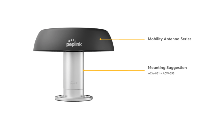

  • Product CodeDescription
    ACW-6511″ 14 TPI Female to Mobility Thread
    ACW-6531 1/4″ 11 TPI Male Adapter
    * ACW-652 is not compatible with Mobility 42G.
