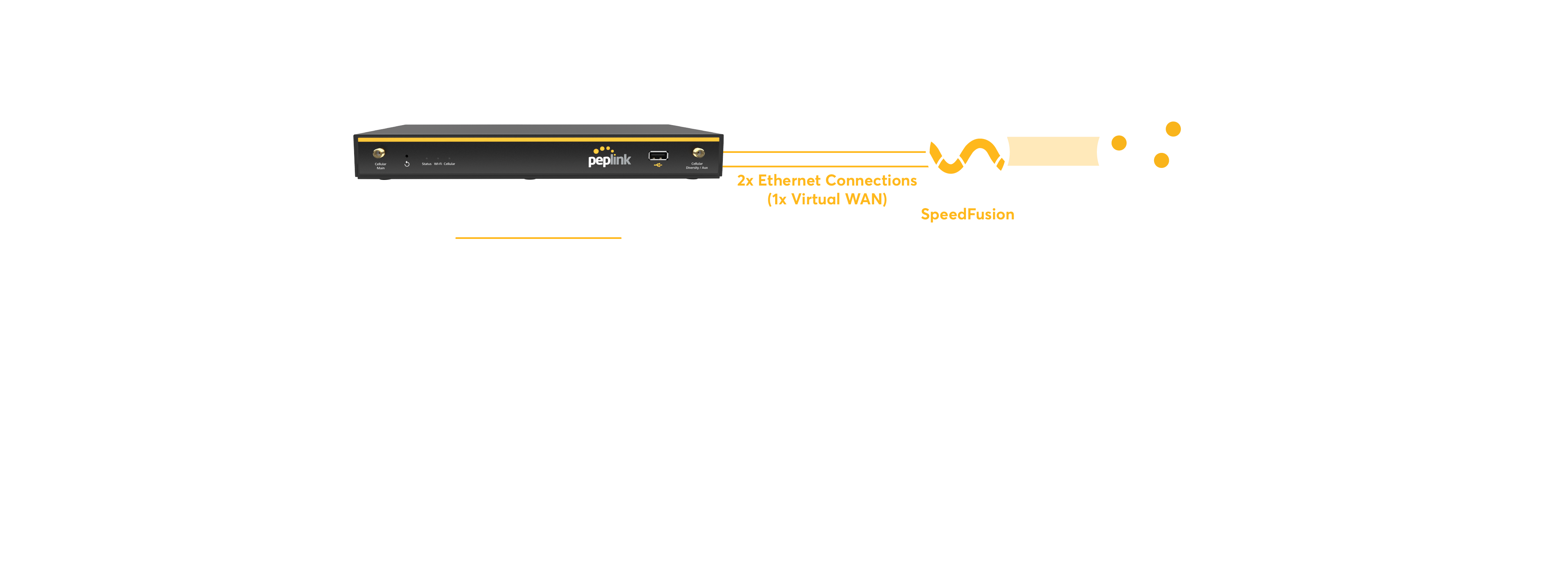

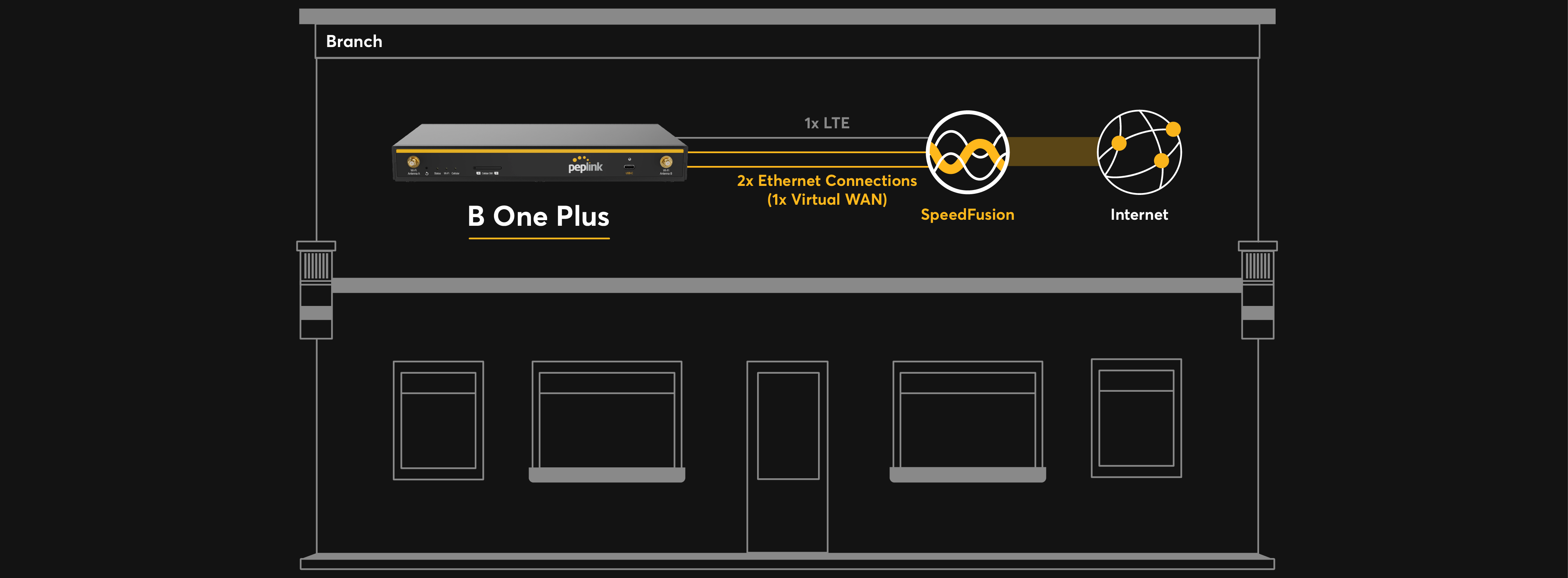

Scenario 1: Balance 20X
The Balance 20X is a PrimeCare model, which means it enables 1 Virtual WAN support by default, so it’s easy to obtain 2 wired ethernet connections to work alongside the built-in LTE. In addition, it can support up to 3 Virtual WANs over VLAN for quick and easy deployment.

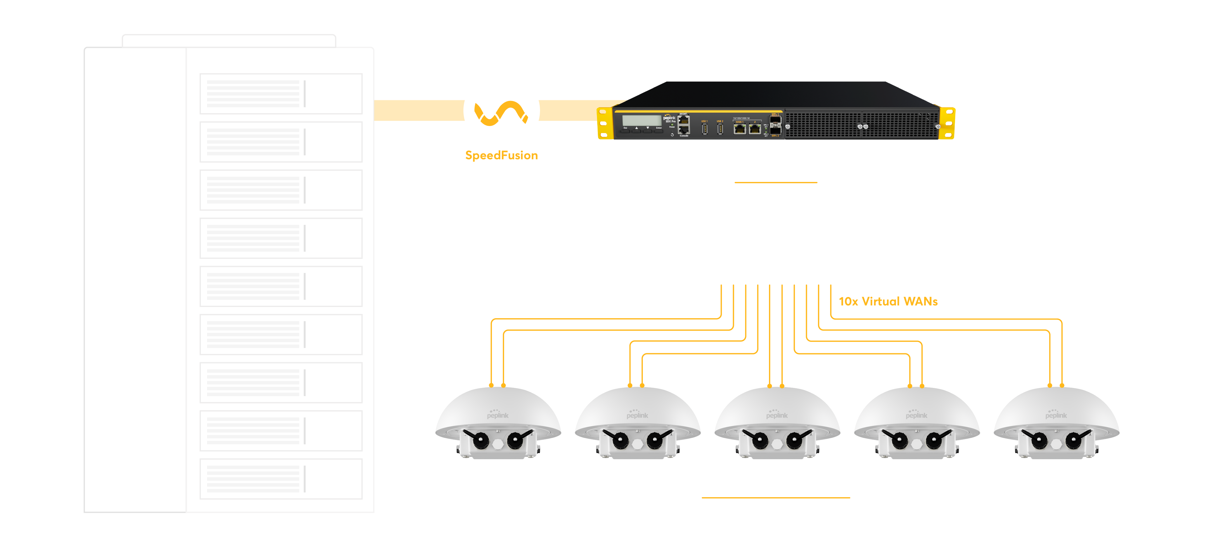

Scenario 2: SDX Pro
Enable up to 10* Virtual WANs over VLAN for your SDX Pro, eliminating the need for physical connections from the HD2 Domes, especially if you have existing infrastructure. Simply connect the HD2 Domes to your existing managed switch, and run 1 fiber optic cable to the SDX Pro, providing 10 LTE connections in 1 cable!
*10 Virtual WAN (20/30/40 Virtual WANs) is not supported by default and requires special firmware.

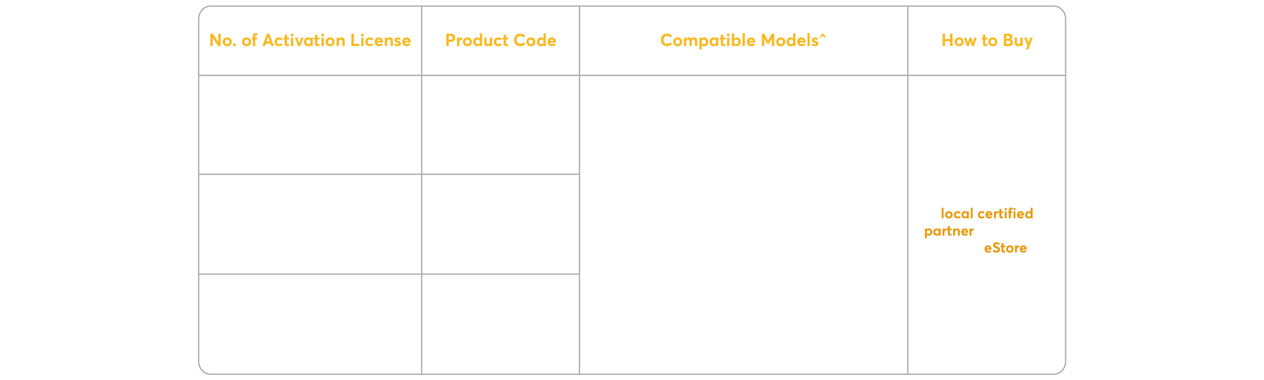

Supported Models & Ordering Information
^ Models with an active PrimeCare subscription will include One Virtual WAN on VLAN.
*You can find your local certified partner here or our eStore here.
