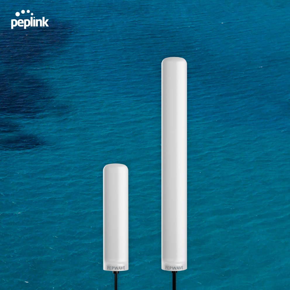

Peplink’s Maritime Antenna Series, designed with ultra high gain and enclosed by IP68 rated cases, can make sure you have the least cellular blackspots at sea.
Choose a model from them to be paired with your router based on your needs. But no matter what you need, Peplink can provide you with the right gear.

Not sure if the 5G signals can manage to travel this far and reach your router before they get blocked? Don’t worry, Maritime 10 can help. With its 9.3dBi gain, this antenna enables ultra long-range reception, even of 5G signals, which only travel short distances and are easily blocked.

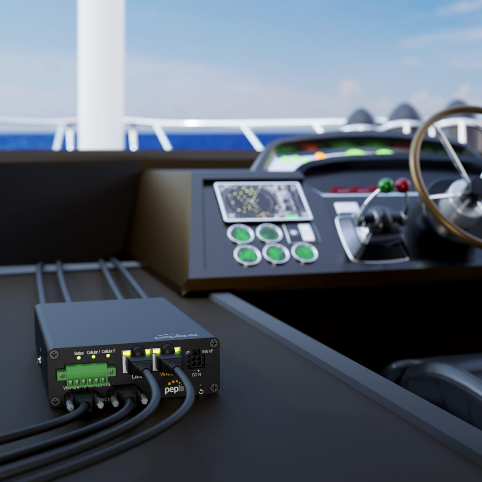

Have a Transit Duo Pro as company for both higher bandwidth and enhanced reliability. With 2 LTE modems and 1 Ethernet WAN port, this router enables you to utilize up to 3 WANs concurrently.
Combine the 2 cellular connections for fast and seamless data transmission. When the vessel is out of reach of cellular signals, the Internet will fail over to the satellite link. This results in the highest possible cellular uptime and always-on connectivity.
A 5G alternative to this router would be the BR2 Pro. It can be paired with 4 Maritime 20G antennas for less drilling. If you are looking for even more 5G WANs, add a MAX Adapter 5G to have the third 5G connection.

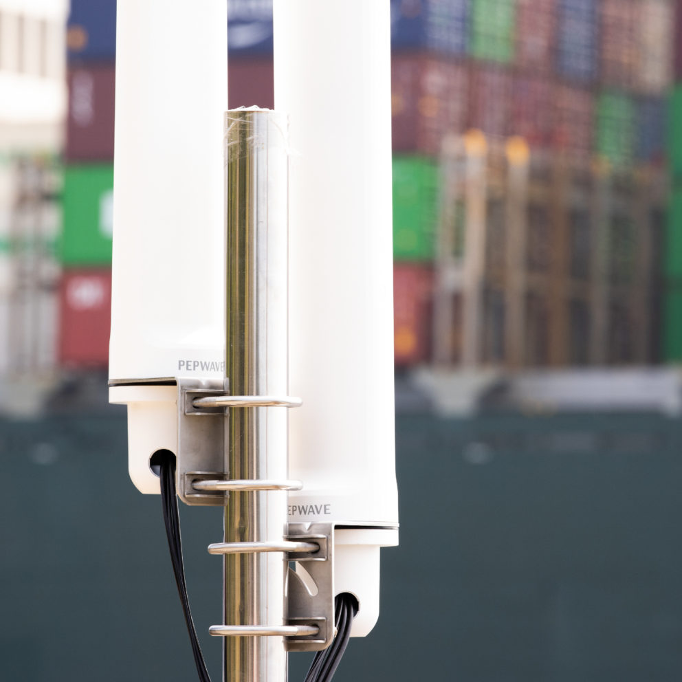

Use a MAX HD4 MBX 5G along with a SIM Injector. Connect the router to 4 Maritime 40G antennas to safeguard the long-range signal reception.
