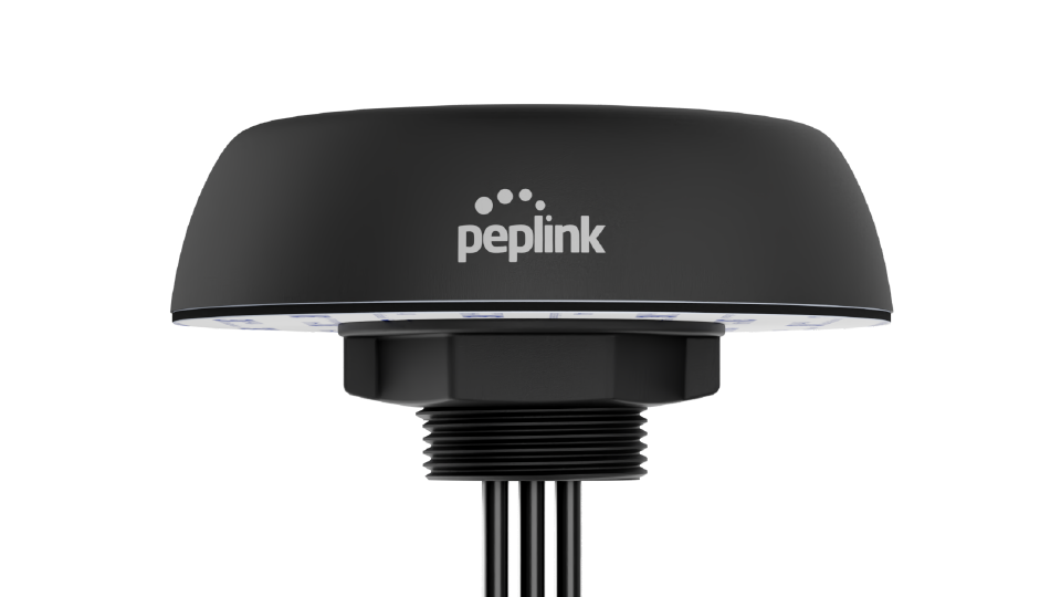

Mobility 40G
4x Cellular | 1x GPS
With 4 cellular channels, the Mobility 40G is a powerhouse capable of delivering high bandwidth and solid reliability under heavy use. Equipped with high gain LNA, the GPS receiver has improved location tracking.
The Mobility 40G is ideal for large-scale public safety, mobile healthcare, mobile command, and other operations using a large volume of data.

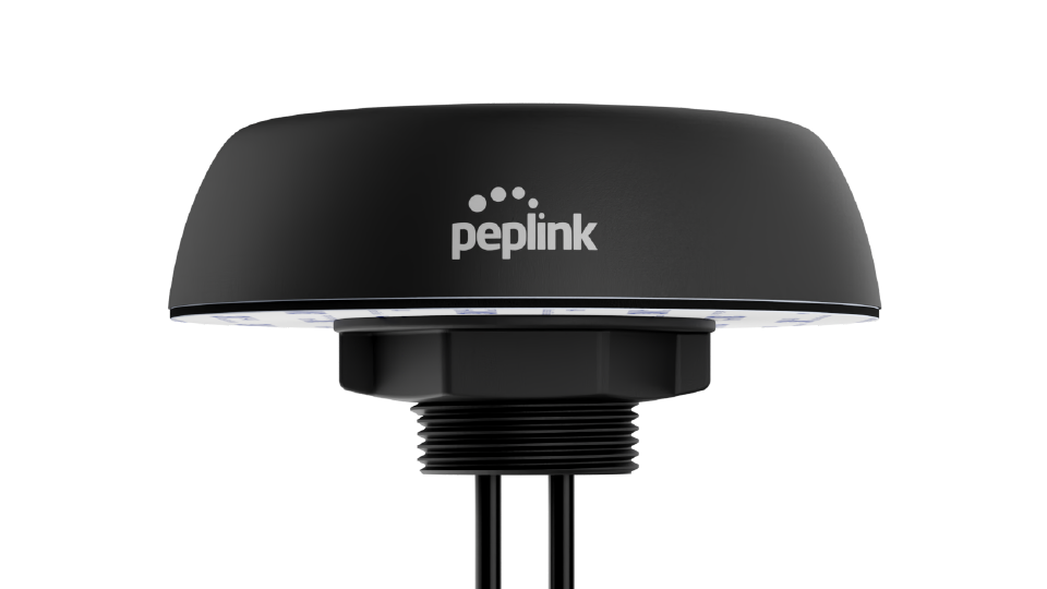

Mobility 20G
2x Cellular | 1x GPS
The Mobility 20G comes with 2 cellular channels and 1 high gain LNA GPS built for reliable LTE or 5G connectivity. Housed in a robust exterior, this antenna can provide high bandwidth for mobile applications.
The Mobility 20G is ideal for small-scale public safety, mobile healthcare, and transportation connectivity.

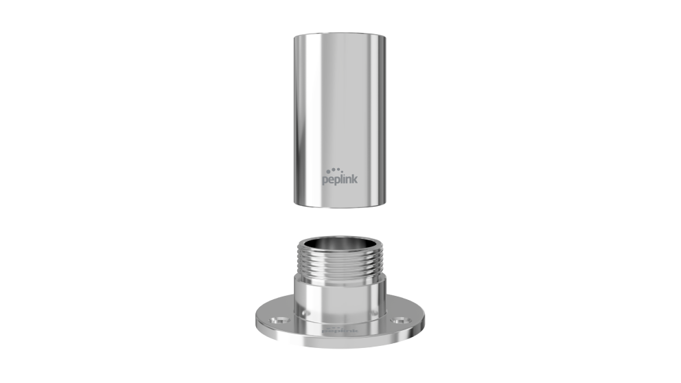

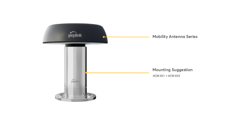

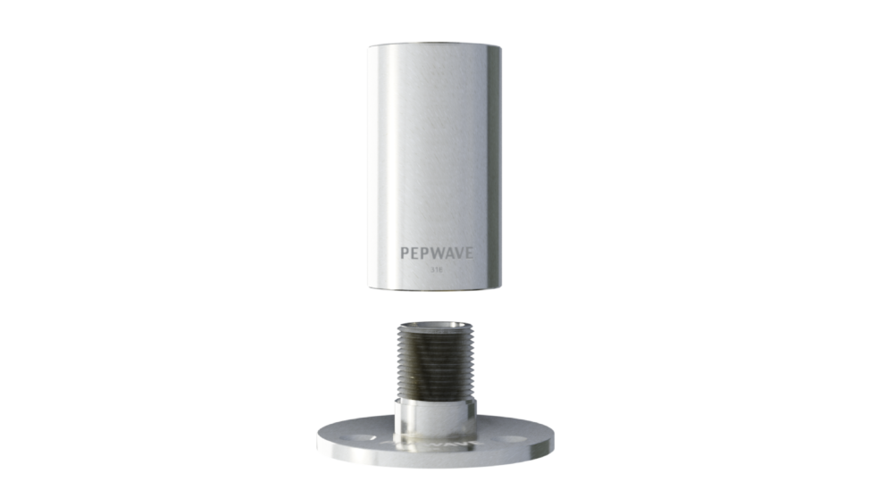

Premium Deck Mount
Rugged and heavy duty mounts are intended for deck and mast installations. The cable is protected inside the mount with direct feed through the deck or mast.
This mount is made from the highest quality Marine Grade Stainless Steel to withstand harsh weather conditions and prevent corrosion at sea.

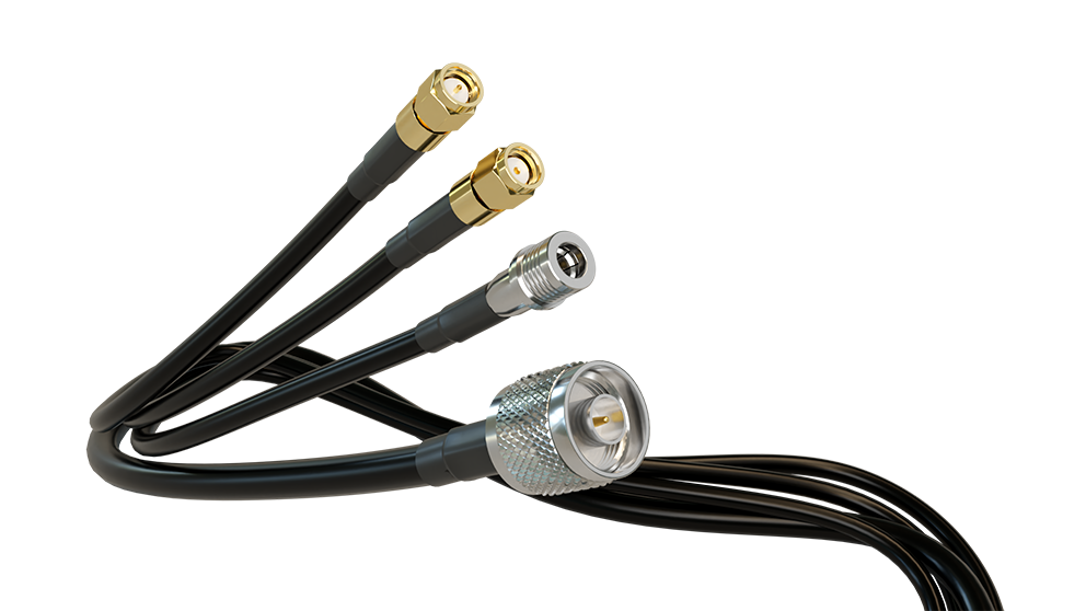

Extension Cables
A full array of UV stabilized and low-loss extension cable options with different connectors and lengths to meet any of your antenna needs.

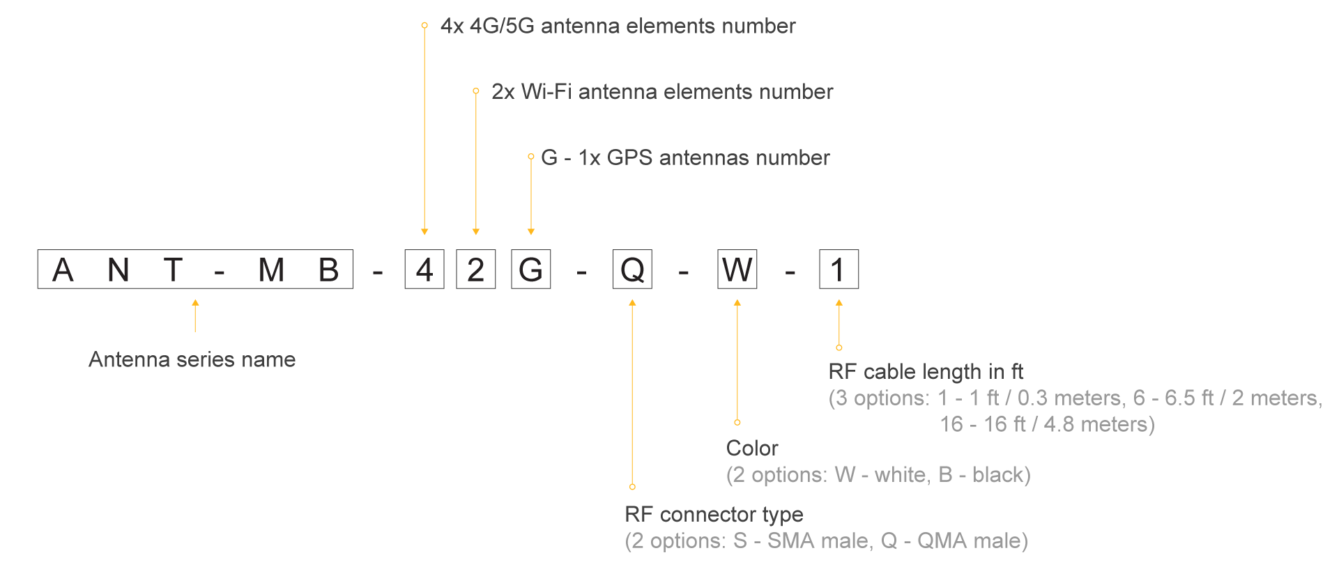

    Q. What does each letter/ number on Peplink Mobility series on the SKU numbering stand for?
    Each number and letter after the series name, has its own meaning and purpose. Here’s what it stands for:
      ⚬ The first number represents the number of LTE element
      ⚬ The second represents the number of  Wi-Fi element
      ⚬ The third  represents the number of  GPS element
    The next letter in the SKU numbering represents the RF connector type, there are 2 options for this: S-SMA male; Q- QMA male.
    The letter following this will simply represent the color of the model: B- Black; W- White.
    The final number will represent RF cable length ft: 1-1ft/0.3 meters; 6-6.5ft/2 meters; 16-16ft/4.8 meters.
    Q. What cable length options are there for the Mobility Antenna?
    ⚬ Option 1 – 1ft/0.3m for any short-range deployments between the router and the antenna.
    ⚬ Option 2 – 6.5ft/2m for middle-range deployments.
    ⚬ Option 3 – 16ft/4.8m for long-range deployments. Please note that only Mobility 42G comes with 16ft/4.8m cables. Other models will require a short pigtail (ANT-MB-xxx-Q-x-1) plus an extension cable (EXC-xQ-15).
    Q. Why QMA is better than SMA/N-type to an extension cable?
    QMA connectors are designed as snap-on locking replacement for the standard SMA connectors. In the case of an extension, using a QMA connector is quick to install and prevents any dispatch in the future in comparison to SMA or N-types.

    ACW-6511″ 14 TPI Female to Mobility Thread
    ACW-6531 1/4″ 11 TPI Male Adapter
    * ACW-652 is not compatible with Mobility 42G.
