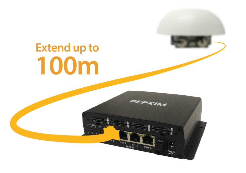

100 meter flexibility can be added with SIM Injector
In addition to adding SIM capacity, the SIM Injector also adds 100 meters of flexibility between the Router and the SIM cards, enabling you to place the cellular router anywhere you want without worrying about changing SIM cards.

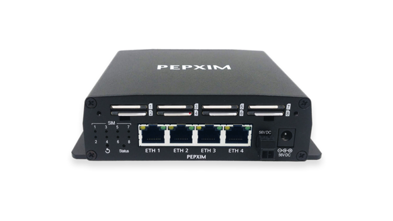

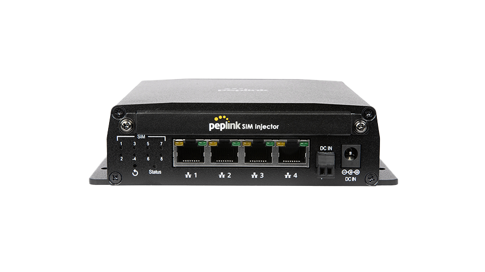

Injector Overview
Specification Description SIM Slots 8x Active SIM Slots, Standard Size LAN Interface 4x GE, PoE 802.3at Support * Power Input DC Jack/Terminal Block: 12-56V Dimensions 1.6 x 5.8 x 5 inches | 40 x 147 x 128 mm Weight 430 grams | 0.94 pounds Operating Temperature -40° – 149°F | -40° – 65°C Humidity 15% – 95% (non-condensing) * 56V DC input is needed for 4x LAN ports to have 802.3at
Product Code Description SIM-BK8-4E-56V SIM Injector, 8x SIM cards capacity, 4x 10/100/1000 LAN ports, 56V DC -
- Power cable (ACW-614)
- Power supply (ACW-622)
