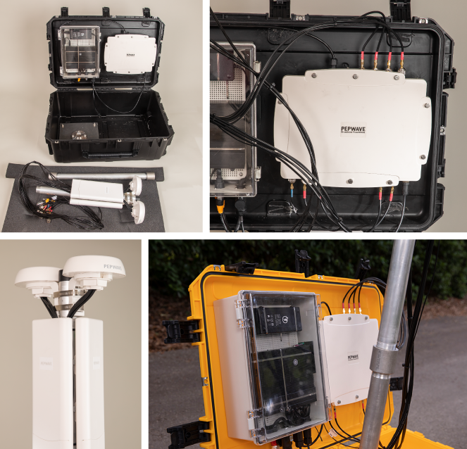

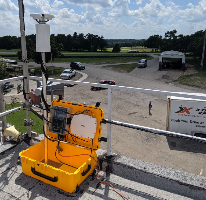

With the nature of this field being outdoors and always on the move, West Networks implemented their famous weather-resistant SpeedFusion Case to transport the perfect Peplink setup whenever needed.

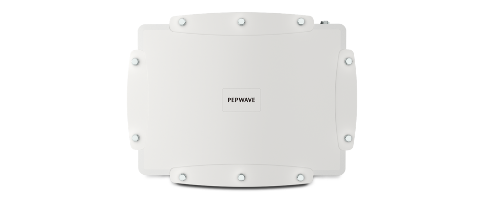

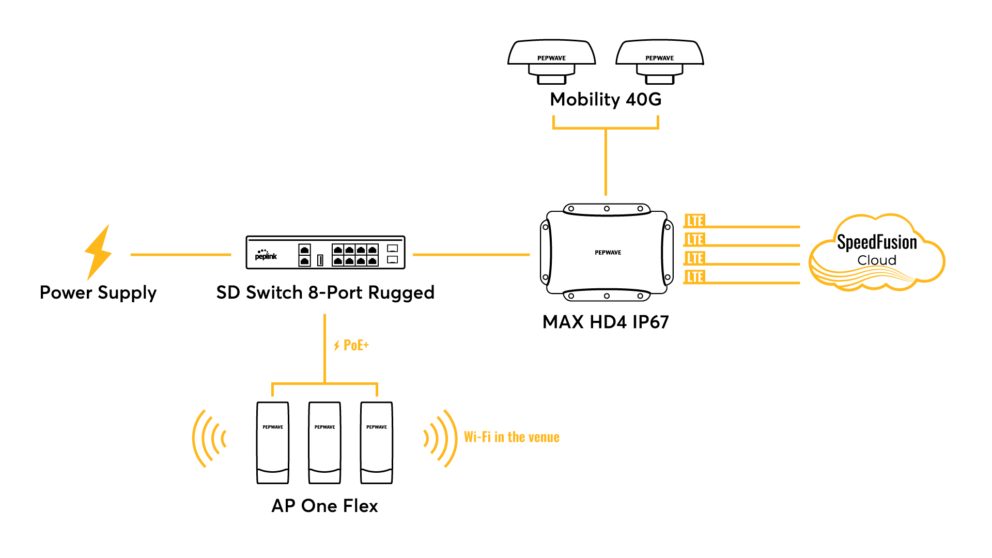

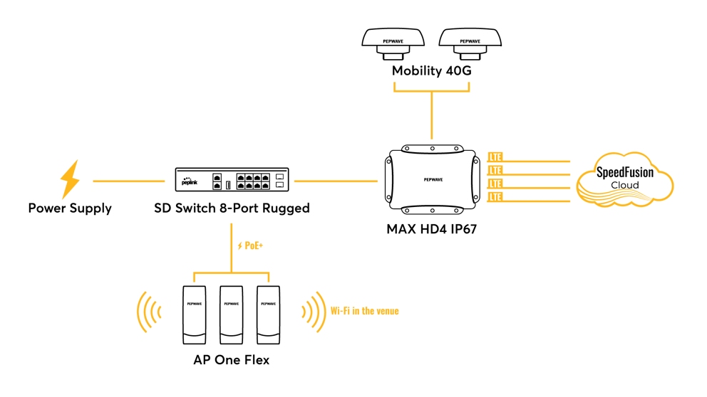

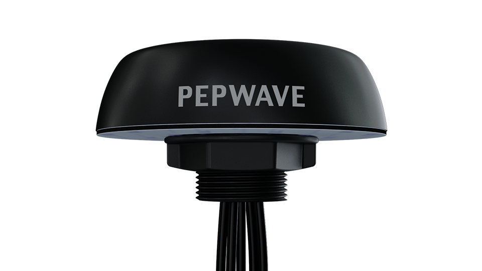

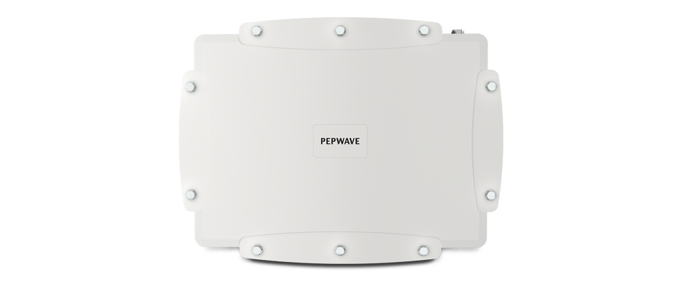

A high throughput quad cellular Peplink HD4 IP67 was introduced, coupled with two high gain Mobility Antennas to receive all cellular signals with minimal loss. The HD4 IP67 is designed for heavy duty applications which, in this case, will be exposed to the environment.
Three AP One Flex’s were installed in a 360 degree arrangement on an extendable metal pole so they were located high up, avoiding as many barriers as possible that may affect the signal strength. These were linked to an 8 port SD-Switch within a custom IP67 box with external panel ports to allow for waterproof ethernet connections.
This configuration can easily handle the connectivity needs for the entire event area.

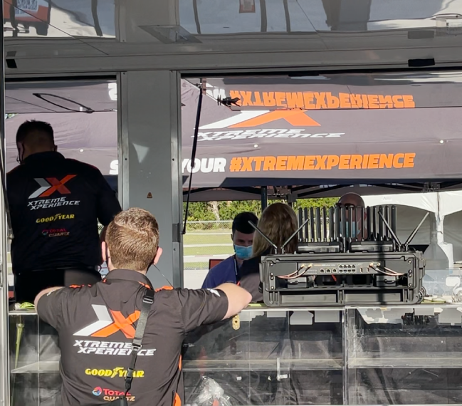

Thanks to West Networks and Peplink, a portable yet versatile setup was deployed providing full event Wi-Fi coverage for all areas of the event. The quad cellular networks were combined together using Peplink’s Bandwidth Bonding to create one large high bandwidth tunnel. Xtreme Xperience can even receive a full 4 bars of signal from up to 1000 feet away from the unit!
