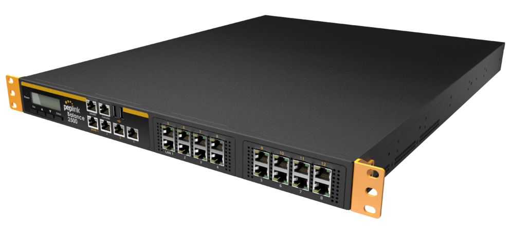

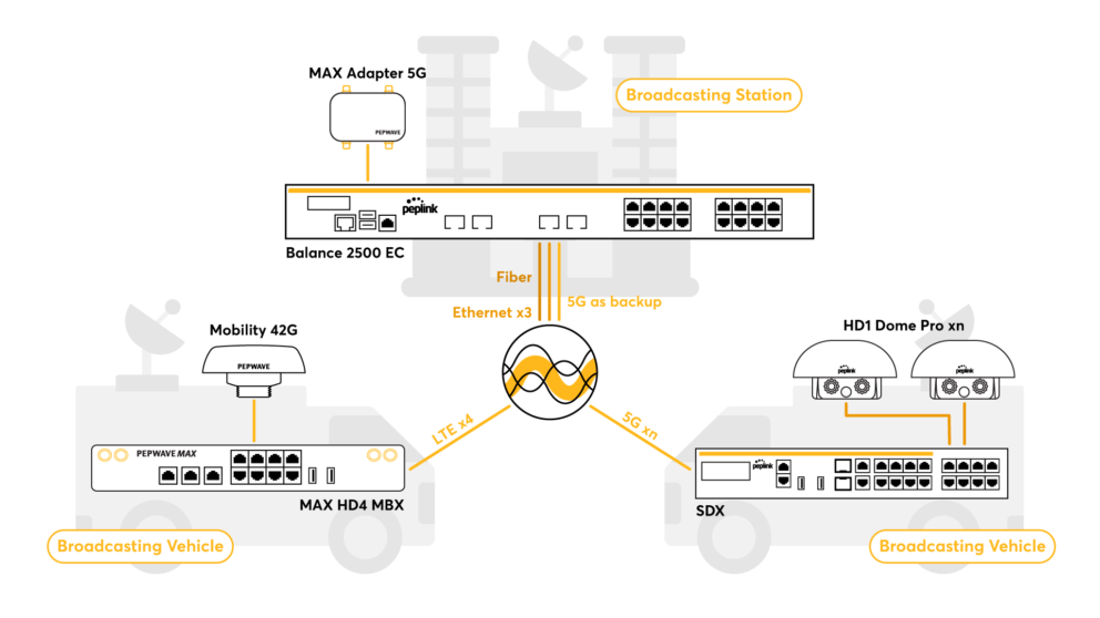

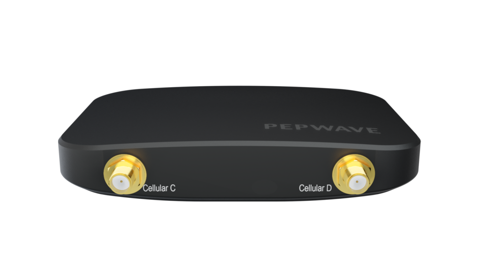

The MSPs thoroughly examined the broadcasting company’s vehicles and station to build a solution. At the broadcasting station, the MSP set up a Balance 2500 EC to utilize both Ethernet and fiber lines. A MAX Adapter 5G was added as an emergency failover to 5G in the event the wired connections all drop.
For the first type of broadcasting vehicle, SDXs were deployed to the inside of each one. On the roofs of the vehicles, depending on the vehicle size, at least two HD1 Dome Pros were mounted on the retractable pole mounts or on the roof itself.

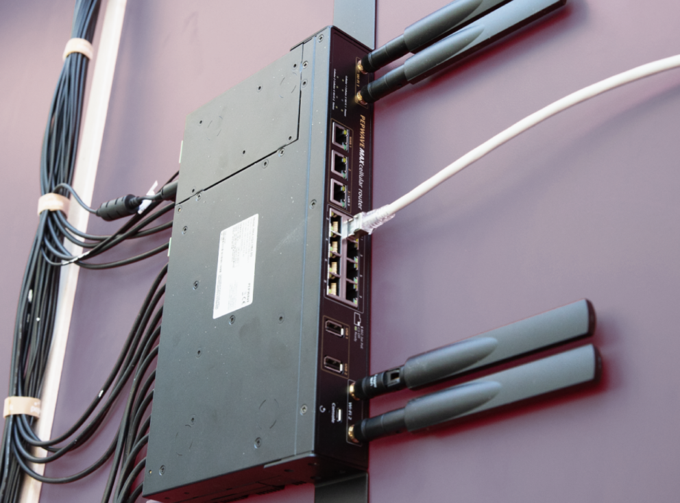

An MBX, for multi-carrier connectivity, was then placed on the smaller vans since they were to remain in areas where cellular signals are accessible. To enhance signal reception, Mobility 42G Antennas were installed on the vehicle’s roofs.
Both the HD1 Dome Pros and Mobility 42G were able to bring their respective vehicles with better signal reception, while the Domes also brought 5G connectivity. WAN Smoothing was also used between the vehicles and the station to smoothen the live video feeds and minimize latency and jitters.
The Balance 2500 EC came with 1 TB of built-in storage and helped process data for streaming optimization. With Peplink devices on multiple ends of the network, SpeedFusion was enabled. At the broadcasting station, if Bandwidth Bonding wasn’t used to aggregate links into one large channel, Hot Failover was activated to transfer traffic between Ethernet, Fiber, and 5G when the primary link dropped.

- Deployed to the broadcasting station
- Easily supports over 1000 concurrent users with multiple WANs
- Performs edge computing with 1 TB of built-in storage

- Placed in smaller broadcasting vehicles
- Enables up to 4 cellular connections from multiple carriers

- Adds a 5G failover connection
- Compact form factor for portability
