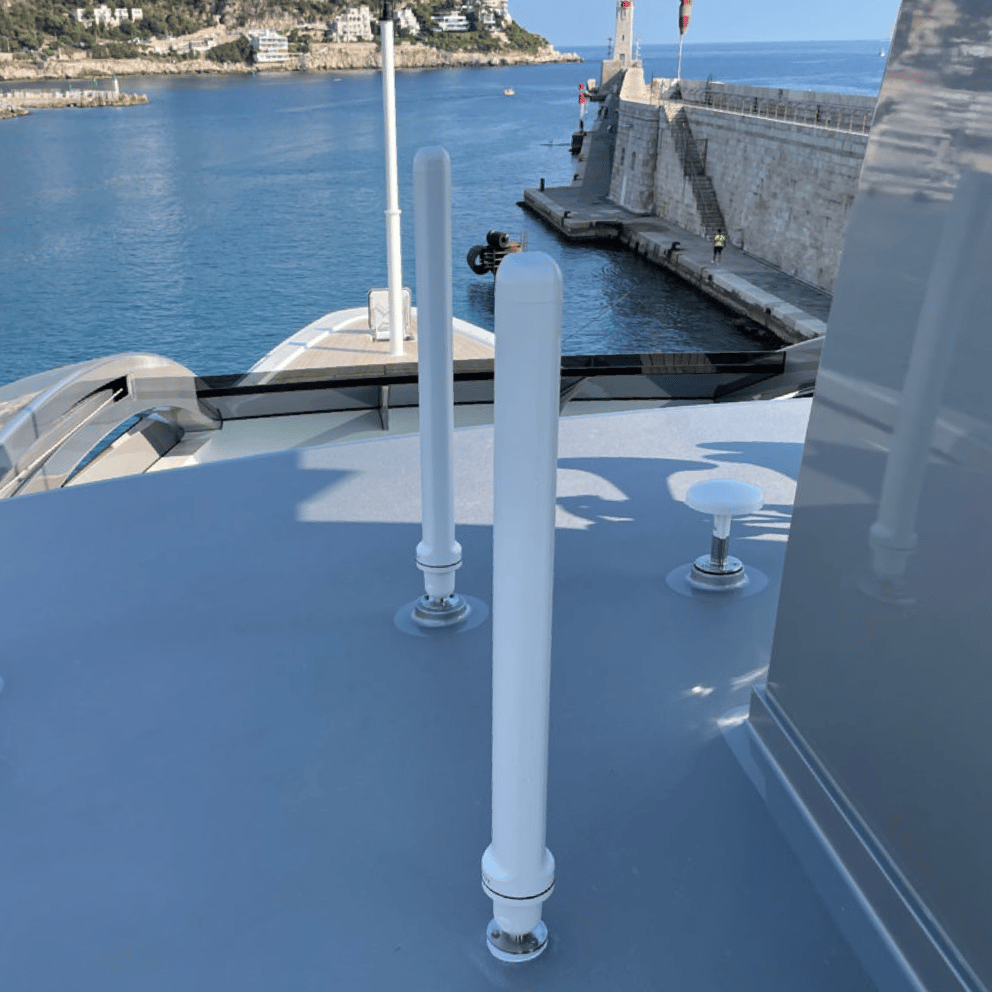

In this case, four Maritime 10 antennas were installed by our service provider on the yacht.
These maritime antennas can receive and transmit signals over longer distances.
With a wide bandwidth, Maritime 10 antennas can deliver high performance in all bands for the best 5G and LTE connections at sea.
The modern, sleek, compact design makes it a perfect fit for yachts.
