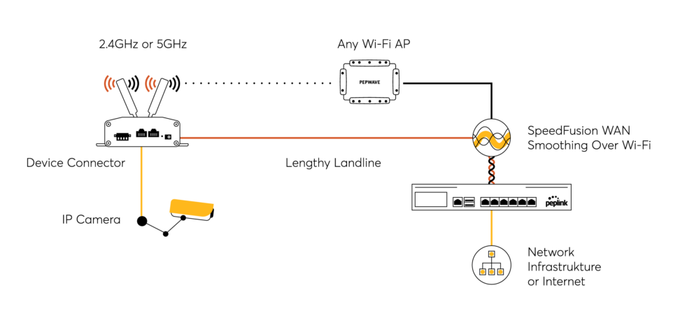

SpeedFusion Between Wi-Fi and Landline
Sample Topology
2.4 5GHz IndoorOutdoor Wireless Bridge #4
The Device Connector can combine a wired landline connection and a Wi-Fi connection. This configuration provides extra connection resilience and diversity: if one connection breaks, the other can still take over.
