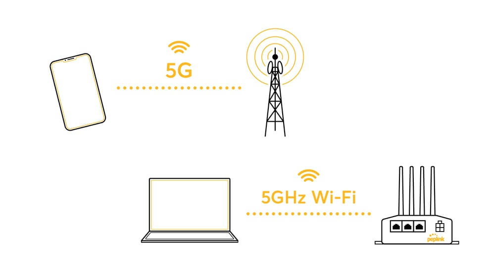

Here’s the main difference between 5GHz and 5G: While both 5GHz WiFi routers and 5G cellular routers use radio waves to enable wireless communication, and both can operate on the 5GHz frequency, they use different radio wave technologies to connect, and are for different purposes.
5GHz WiFi is used by the standard routers that many people have. 5GHz WiFi routers use short range radio frequencies to connect devices in your office to your router, and then your router connects to the Internet. These 5GHz WiFi routers transmit a signal to your devices on one of two frequency bands, 2.4GHz or 5.0GHz.

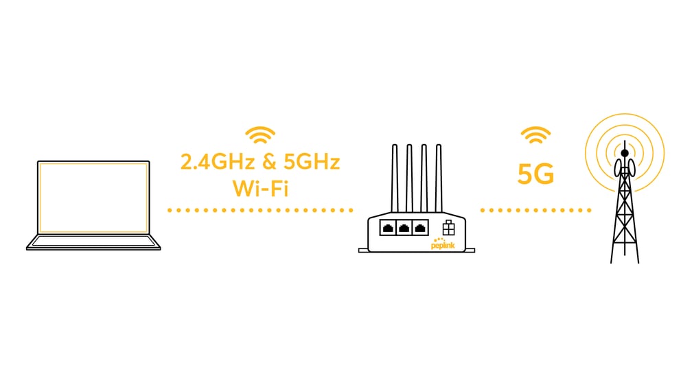

5G vs 5GHz - Are they the same?
It’s a Cellular Router – 5G doesn’t refer to a specific frequency band. “G” refers to generation, and 5G means the fifth generation of mobile, cellular network technology, which encompasses a range of frequency bands and technologies for seamless wireless communication.
5G cellular routers connect to the Internet over longer distances – up to several miles – by way of cellular service provider towers, and primarily operate on frequency bands higher than those used by WiFi, like sub-6GHz and mmWave (millimeter-wave) bands. These bands are different from the 2.4GHz and 5GHz bands used by standard WiFi routers. They offer significantly faster data download and upload speeds, reduced latency, and the ability to connect many more devices at once compared to 4G cellular networks. Read more about the differences between 5G and 4G routers here.
