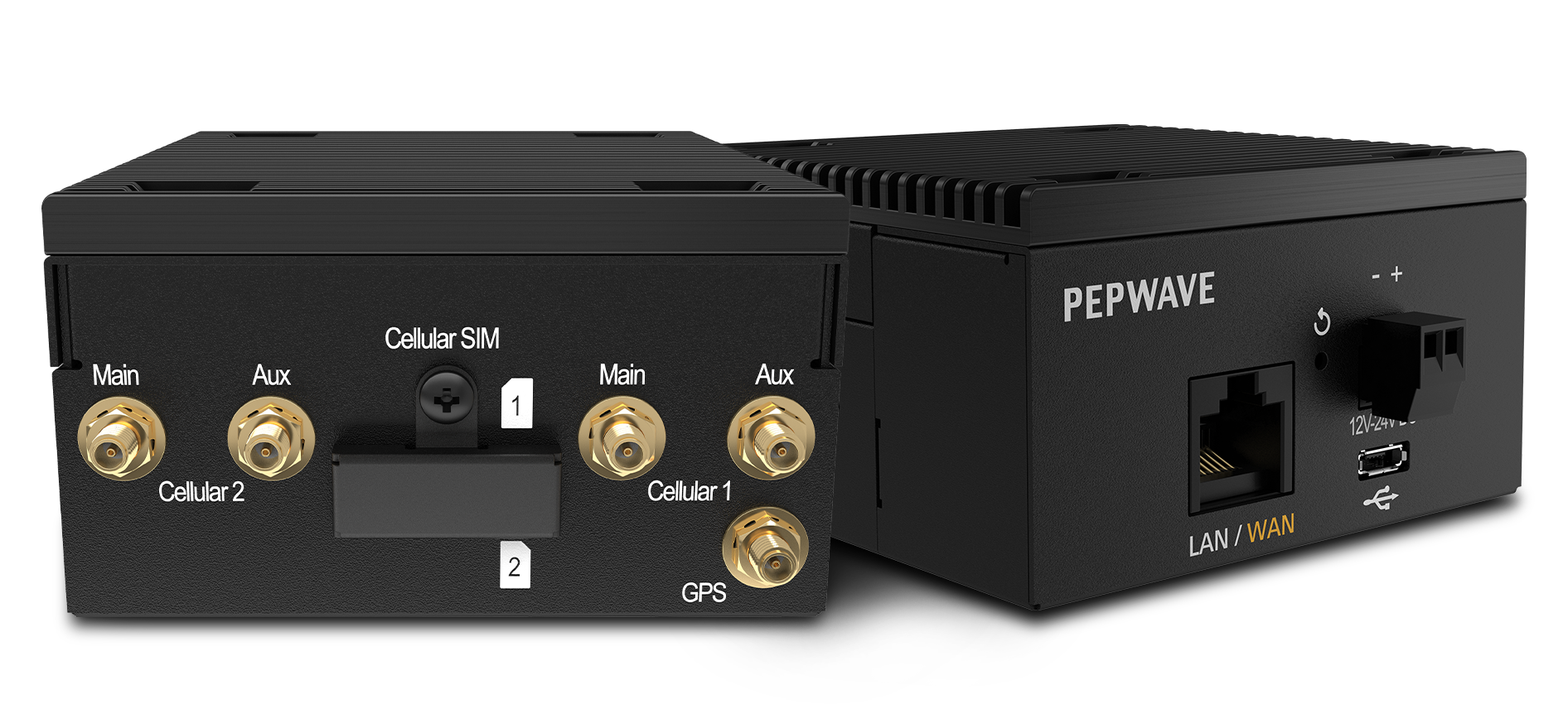

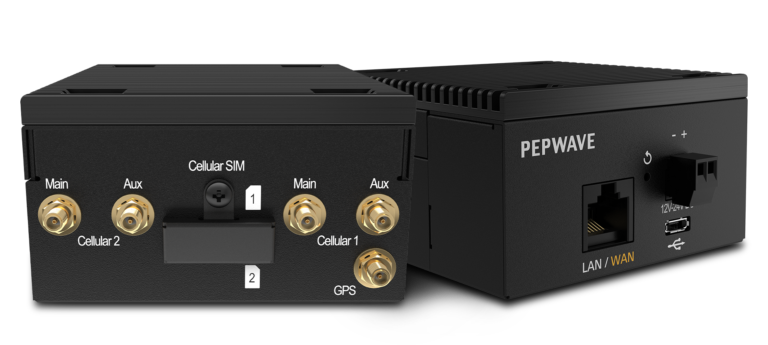

Ultra-Compact SpeedFusion SD-WAN
The SpeedFusion Engine fits in the palm of your hand, making it easy to integrate into your existing products.
Combine 2 Cellular Connections
With a Peplink router at HQ, SpeedFusion SD-WAN technology combines 2 cellular connections to ensure reliable connectivity, no matter where you deploy.
Plug-n-Play Integration
With an Ethernet port, a USB port, and 10W consumption, the SpeedFusion Engine can integrate with your devices without complicated software porting.
