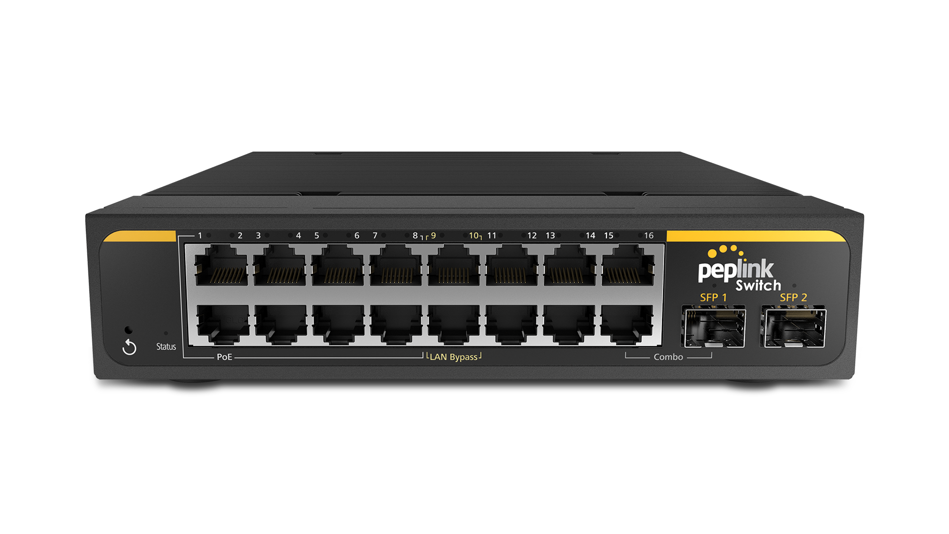

Fanless Design. Ready for Any Environment
The SD-Switch Rugged can handle -40°F (-40°C) to 149°F (65°C). The fanless design enables it to function in high-particle environments.

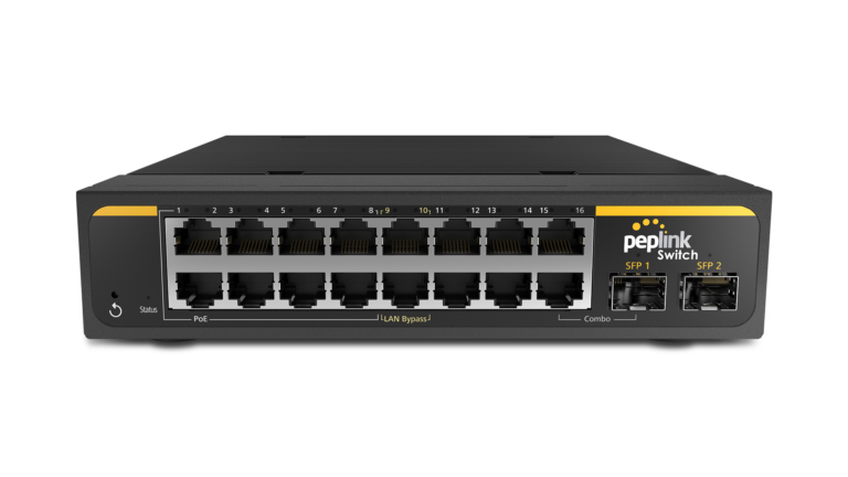

Combo Port
ETH 16 and SFP 1 are a combo ports that share the same port number. This enables you to use either interface without configuring additional ports on client devices.

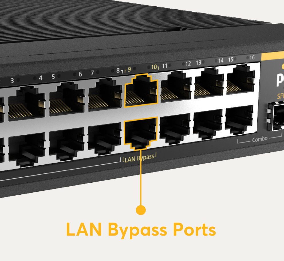

LAN bypass Ports
In the event that the switch loses power, the LAN bypass ports will still connect. This enables you safely connect the switches in a daisy chain configuration.
  • LAN Interface8x 802.3at (PoE+) GE Ports*,
    8x GE Ports,
    2x SFP Ports
    VLAN GroupsYes
    Fiber Module2x 1 Gbps
    Switch Capacity36 Gbps
    Max. Packet
    Forwarding Rate
    26.8 Mpps
    MAC Address Table8,000
    Inter-VLAN RoutingNo
    AC AdaptorAC Input 100V-240V
    DC Output 54V^
    Power InputDC Power DIN 2x 54V
    Terminal Block: 12V - 56V DC
    Power
    Consumption
    20W System,
    90W PoE+ Power Budget
    (supports up to 240W^ )
    Dimensions
    (L x W x H)
    7.5 x 9.0 x 1.5 inches |
    190 x 226 x 35 mm
    Weight4.4 pounds |
    2.0 kg
    Operating Temperature-40° – 149°F |
    -40° – 65°C
    CertificationFCC, CE, RoHS, E-Mark, IC
