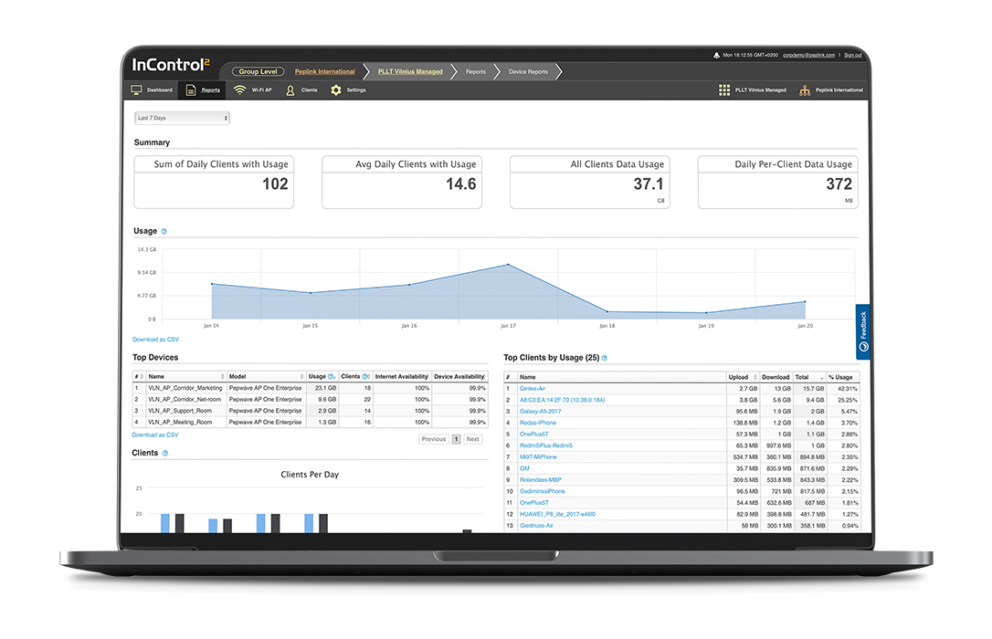

PDX is supported by InControl2, Peplinks Cloud-Based SD-WAN Network Management Platform. Setup SpeedFusion networks, make bulk configuration changes, determine Firmware policy, build a custom captive portal. Do all this and more remotely using the InControl2.

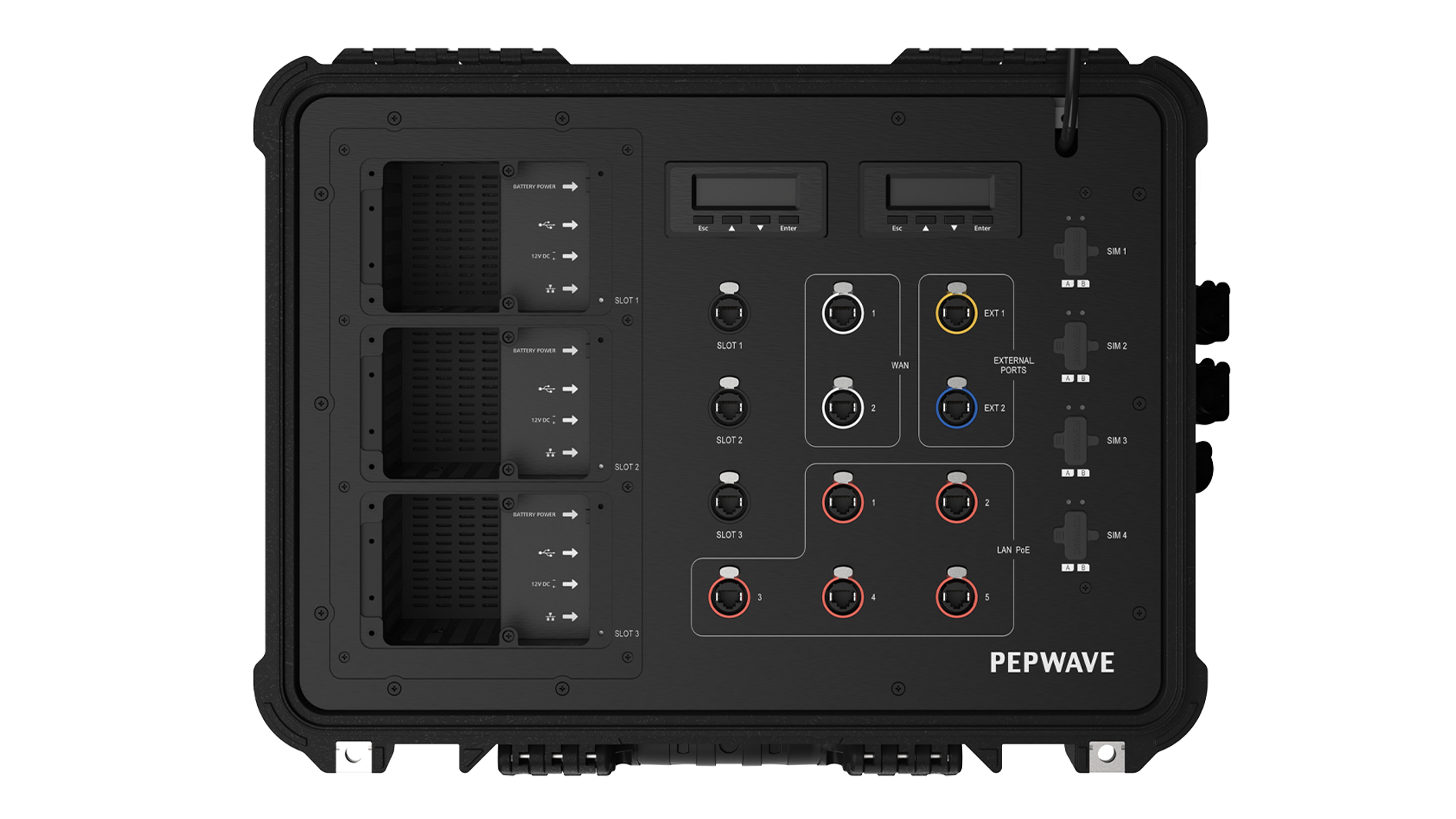

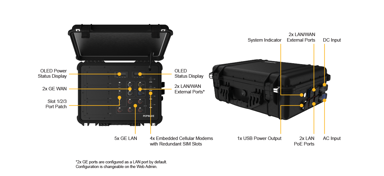

WAN Interface 2x GE Ports*
4x Embedded LTE-A Modems with Redundant SIM Slots
LAN Interface 7x GE Ports* Wi-Fi Interface 802.11ac/a/b/g/n, 1166 Mbps 2×2 MIMO Wi-Fi WAN and/or AP Simultaneous Dual-Band PDX Throughput 2.5 Gbps Number of SpeedFusion VPN 2/20^ SpeedFusion VPN Throughput (No Encryption) | (256-bit AES) 600 Mbps | 500 Mbps Recommended Users 50-500 LTE-A Pro Modems Downlink/Uplink Per Modem:
600 Mbps/150 Mbps
Cellular and GPS Antennas 8x Cellular Antennas (Embedded)
1x GPS Antenna (Embedded)
4x Wi-Fi Antennas (Embedded)
Power Input DC: 12V – 56V, AC: 100V – 240V Power Output Up to 7x 802.3at PoE, 1x USB Power Outputs Power Consumption 38W (max.) Dimensions 19.7 x 14.8 x 7.7 inches |
500 x 375 x 195 mm
Weight 28.7 pounds | 13 kg Operating Temperature -40° – 113°F |
-40° – 45°C
Humidity 15% – 95% (non-condensing) Certifications FCC, IC, CE,
7.7G Vibration resistance, MIL-STD-810H 514.8E-1 Cat24, IP55/65^, [email protected], FirstNet%Warranty 1-Year Limited Warranty * 2x GE port is configured as a LAN port by default, configuration is changeable on the Web Admin. ^ IP55 certified. IP65 certification testing in progress.
