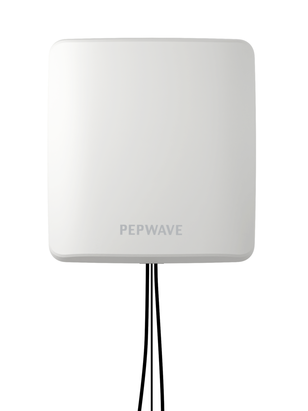

IoT 20G
2x Cellular | 1x GPS
With 2 cellular channels, the IoT 20G is a high-gain antenna optimized for LTE/5G bands. Its IP66 enclosure and support for Band 71 makes this antenna an ideal and easy installation for remote deployments.

The IoT 20G is a 5G-ready outdoor directional antenna. It’s perfect for rural or suburban areas in order to get the best possible signal from cell towers that are oftentimes, far away.
Q2. Why should I choose the IoT 20G instead of other antennas?
The IoT 20G is a high gain (10dBi) antenna ideal for remote deployments with its ability to boost signals for the best possible performance. It is designed to cover a wide frequency range (600-6000MHz), suitable for the LTE/5G networks of today and tomorrow.
Q3. Can my LTE-A Pro (CAT-18) or 5G router with 4x antenna connectors still use the IoT 20G?
Yes, they can. For an LTE-A Pro (CAT-18) or a 5G modem based router you will need 2x IoT 20G antennas to connect to all four connectors. Some CAT-18, CAT-20, or 5G routers may still work with only 2 connectors installed, but for the best performance and connection stability, we recommend utilizing every antenna connector at all times.

Along with the antenna, there is a wall/pole mount, and related screws and straps required for installation.
Q2. Is a warranty included with this product?
Yes, the IoT 20G comes with a 1-year warranty.
Q3. What product options are available?
The antenna comes in two options: 16 ft (5m) cables with SMA connectors, or 2 ft (0.5m) cables with N-Type connectors. The SMA version is ideal for when the antenna is directly connected to the router, while the N-Type can be used with outdoor enclosures or when a longer cable is needed (e.g. LMR-400).
