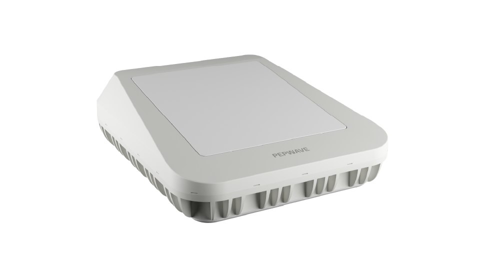

Antenna MAX S HW3
Rapid Deployment.
All-in-One. 5G + Starlink.
Integrated Antenna Enclosure for Peplink and Starlink
Integration to the MAX
One enclosure. One install. All performance.

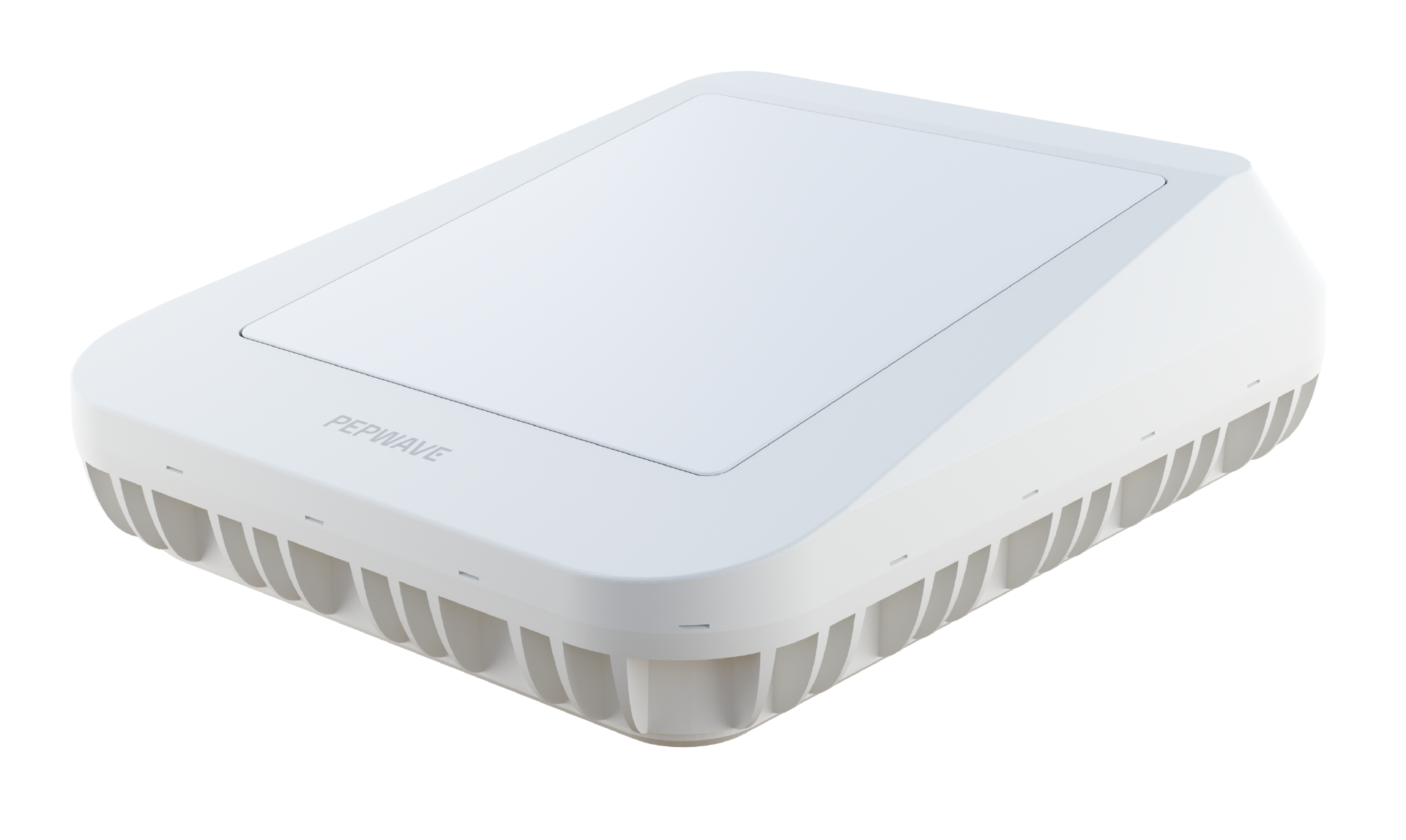

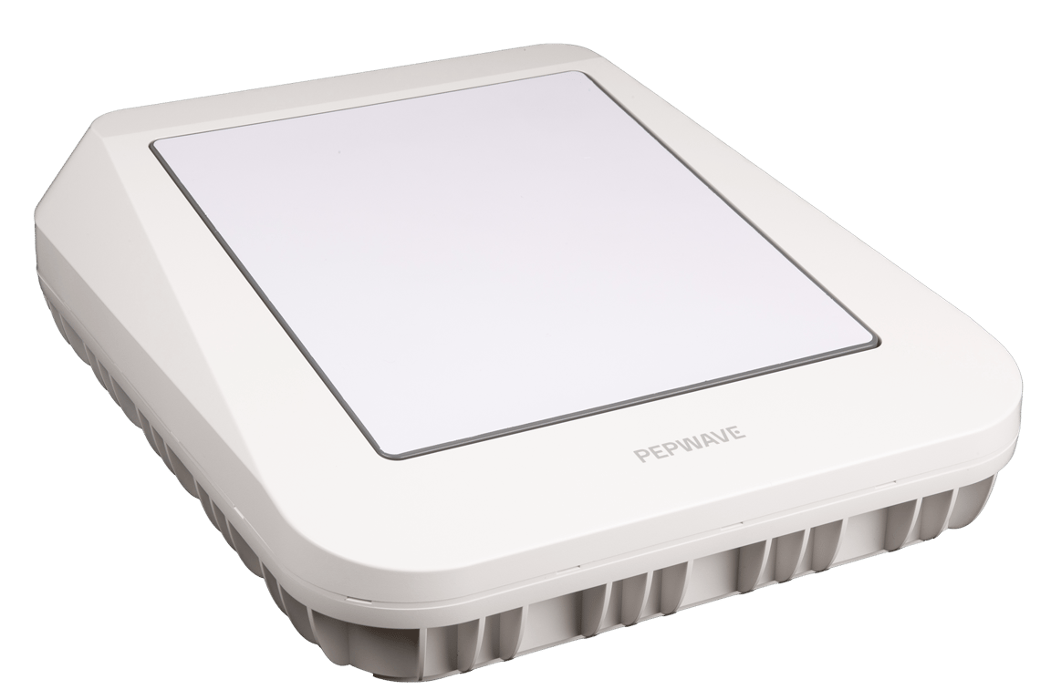

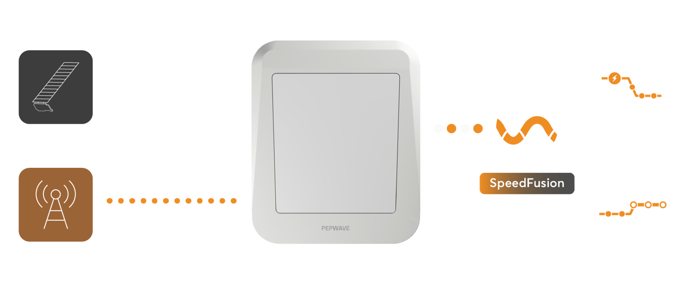

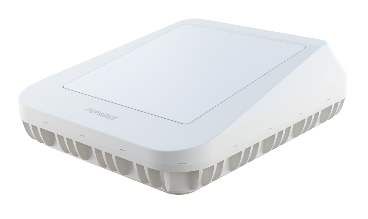

The Antenna MAX S HW3 takes hybrid connectivity to the MAX by combining the power of satellite and cellular in a single, integrated enclosure.

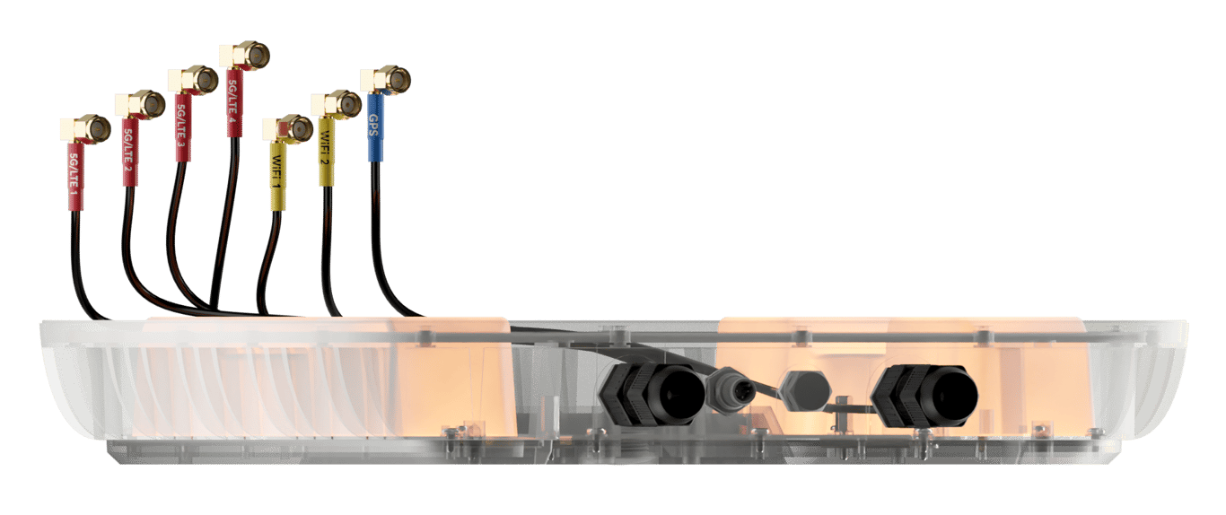

With built-in 4x 5G/LTE, Wi-Fi, and GPS antennas, you can install your Peplink router and Starlink Mini together with no external RF cables required to virtually eliminate signal loss and maintain maximum signal quality.

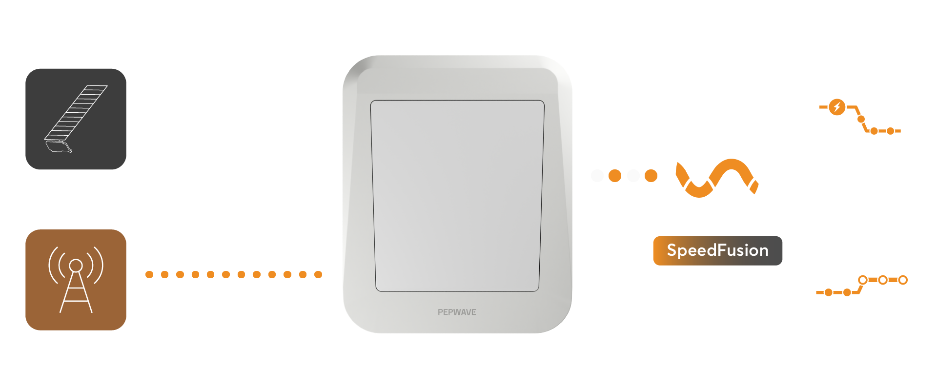

Use Peplink’s SpeedFusion to seamlessly bond or failover between Starlink and 5G, ensuring continuous, high-quality connectivity even in areas with physical obstructions.

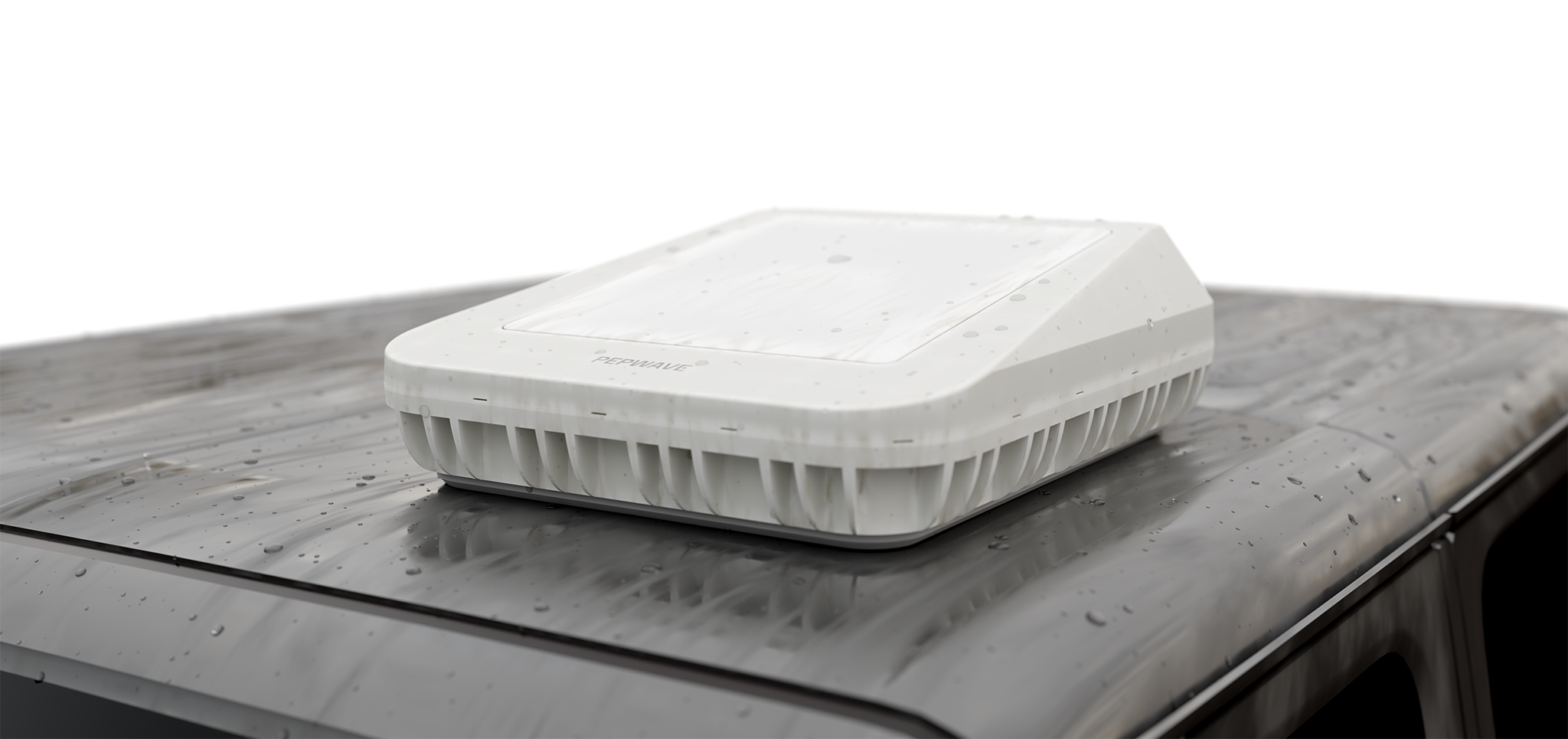

Durability to the MAX

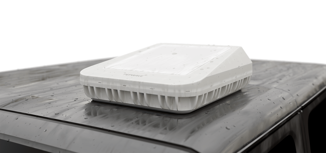

The Antenna MAX S HW3 is engineered for outdoor longevity, built with UV- and salt-resistant plastics, fitted with a metal base for heat dissipation, designed to to withstand high wind loads for fixed or mobile applications.

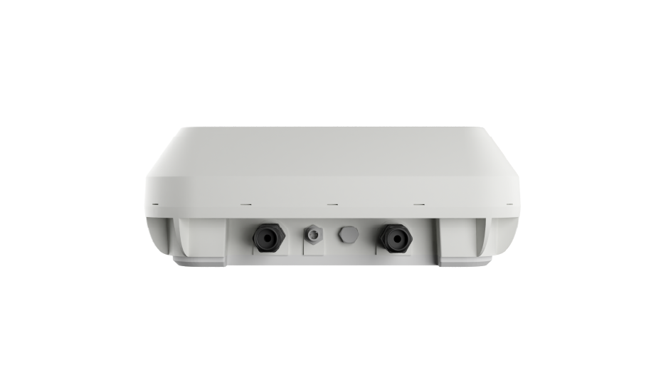

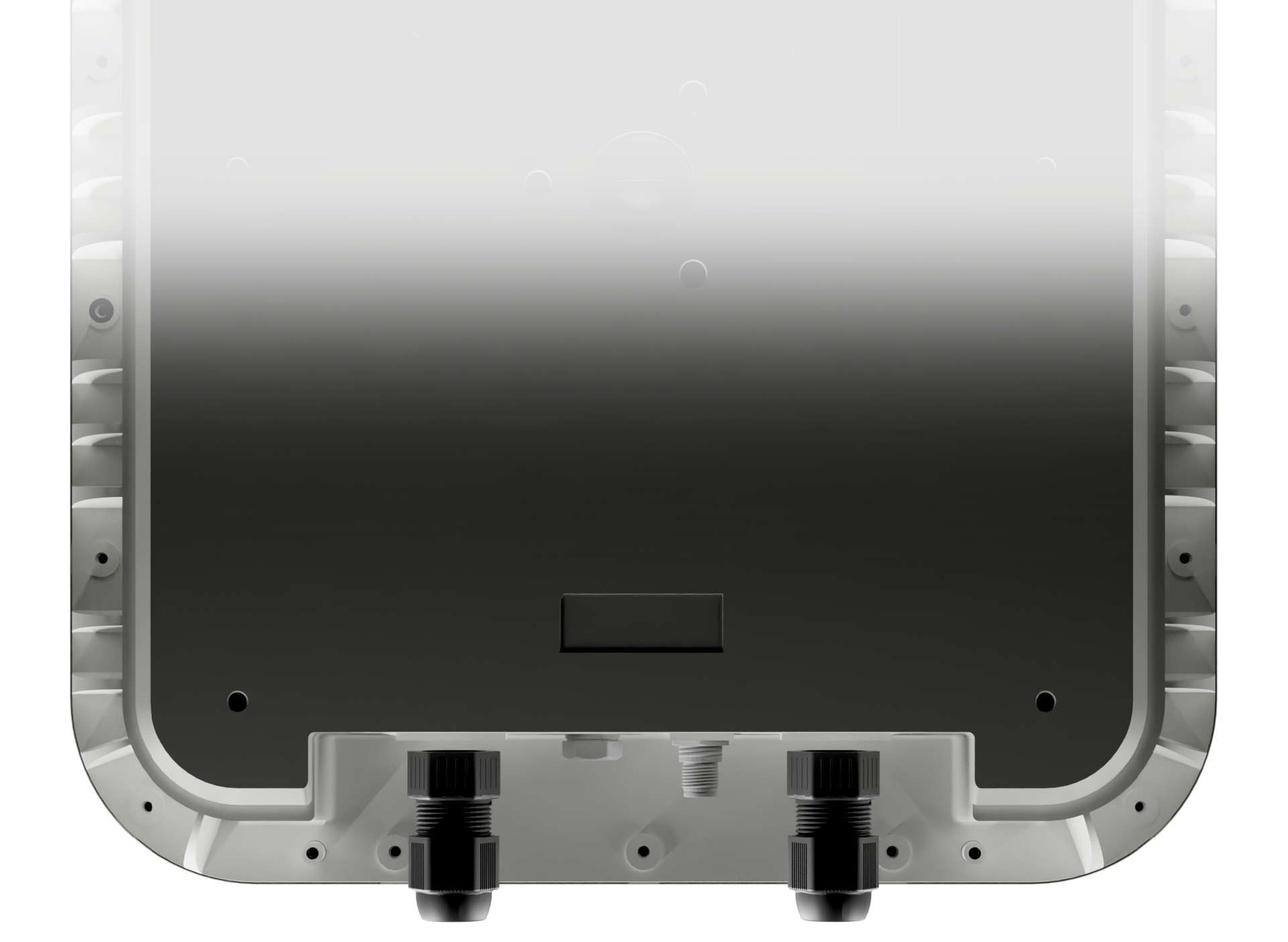

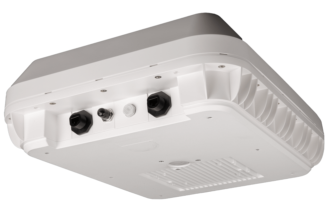

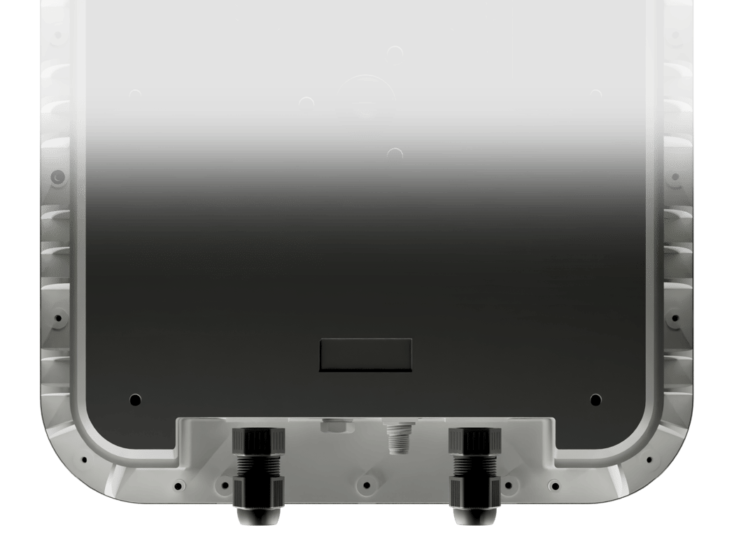

Supporting both Power over Ethernet (PoE) and DC input, the Antenna MAX S HW3 gives you flexibility in how you deploy. Use the top cover’s watertight clasp system to conveniently secure the Peplink router of your choice:
BR1 Mini Series*
Transit Duo Pro
BR1 Pro Series^
*BR1 Mini series: BR1 Mini, BR1 Mini Core, BR1 Mini 5G, BR1 Mini M2M.
^BR1 Pro series: BR1 Pro 5G, BR1 Pro Cat-20.

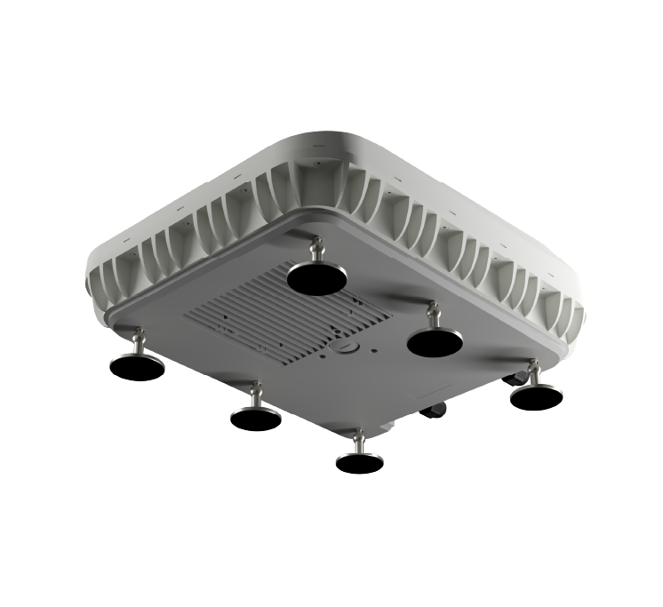

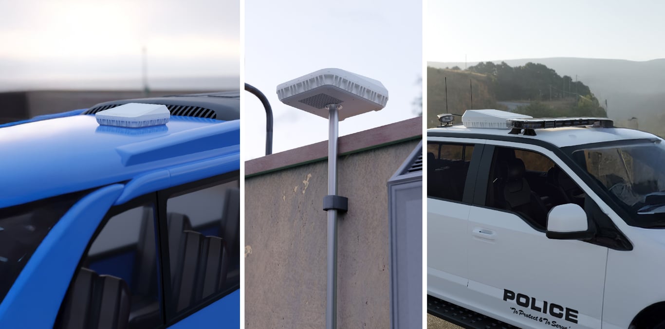

Mount it your way with a variety of installation options ideal for vehicles, rooftops, poles, or even custom rack systems.

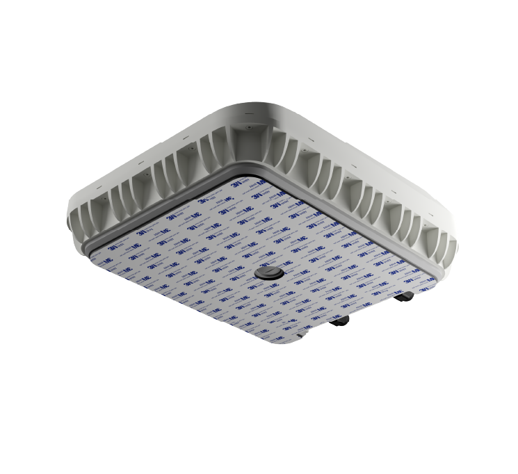

Adhesive Surface Mount
Magnetic Mount

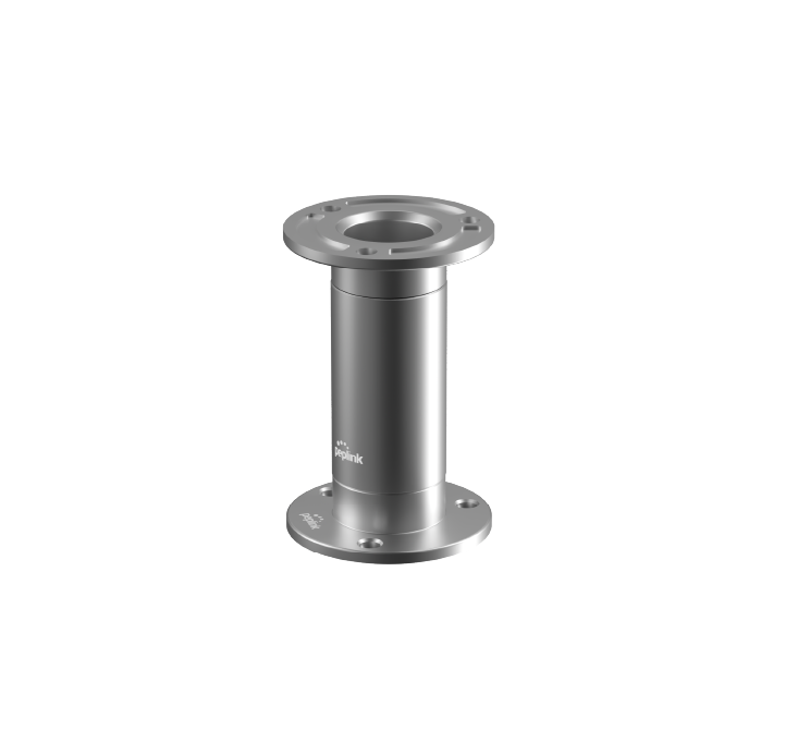

Deck Mount

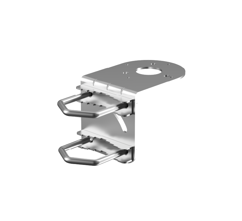

Pole Mount
Surface Mount
Note: The deck, surface, and magnetic mount kits are NOT included in the package.

ACW-651 1" 14 TPI female to Mobility thread for deck mount
ACW-653A 1 1/4" 11 TPI male adapter for deck mount

  • 2x M25 Cable Glands
  • 1x M25 Hole Plug
  • 2x RJ45 Glands
  • 2x RJ45 Caps
  • 2x Hole Plug
  • 1x DC Cable Connector

  • 1x Double sided 3M Adhesive Pad
