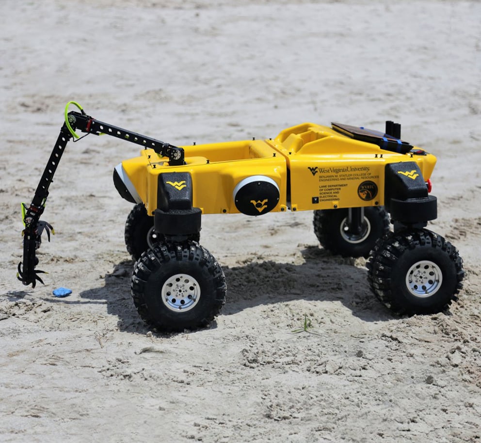

When the Mountaineer Robotics Team at West Virginia University designed and fabricated a sophisticated new Mars Rover, they were excited to compete in the 2016 Revolution Aerospace Systems Concepts Academic Linkage (RASC-AL) Exploration Robo-Ops competition at the Johnson Space Center (JSC) Rock Yard. But they needed a robust, redundant, and reliable network connection. By equipping the 2016 Mountaineer Mars Rover (MMR-16) with the lightweight, rugged Pepwave Max HD2 router, complete with SpeedFusion technology, the Mountaineer Robotics team competed in a harsh environment without any network failures — and walked off with the second-place award.

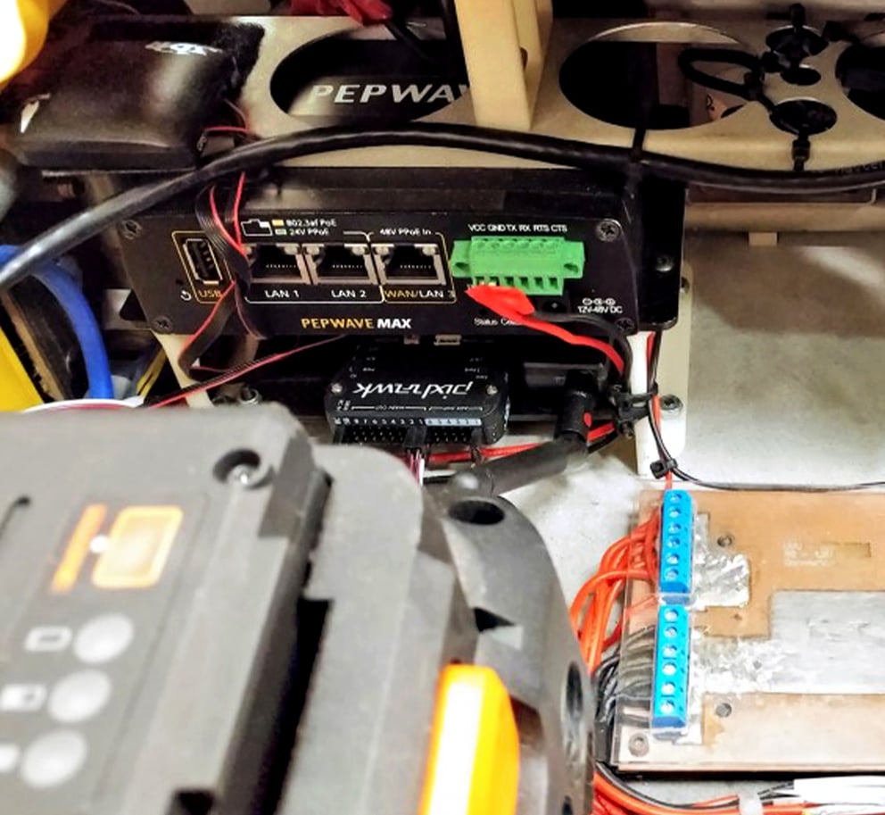

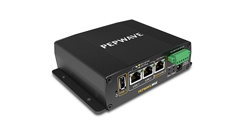

The team ordered the Pepwave Max HD2 Mini 4G LTE Bandwidth Bonding Router three months in advance so they’d have time to integrate the router into the rover. They 3D-printed a sturdy base for the HD2 Mini and affixed it to the MMR-16 so that the antennas had maximum clearance. The HD2 Mini acts as the rover’s backbone communication system. The system handles multiple live camera feeds that enables mission control to remotely survey the landscape and maneuver the rover from many miles away, simulating realistic NASA and rover operations on Mars. Two cellular connections act as the WAN, with multiple carrier networks (AT&T and Verizon) acting as protection against any single network failure. They also purchased a Balance 210 Dual-Wan Router so that they could take advantage of SpeedFusion Bandwidth Bonding.
“We mounted the HD2 Mini on the Mars Rover and used the Balance 210 in mission control,” explained Eric Loy. “SpeedFusion Bonding allowed us to unplug one of the WAN connections from the router in order to simulate a network fault — without ever losing control over the rover. This gave us the best balance of speed and reliability.”
Once the routers were installed, the team configured them easily and they ran successful speed tests using the SpeedFusion VPN Test and Analysis tool. During speed tests, they found that they were achieving a 61% increase in speed with SpeedFusion bonded AT&T and Verizon connections. A third party speed test tool (speedtest.net) reported their average download speeds were 27.3 Mbps and 11.1 Mbps for uploads, far superior to results from their previous setup.
