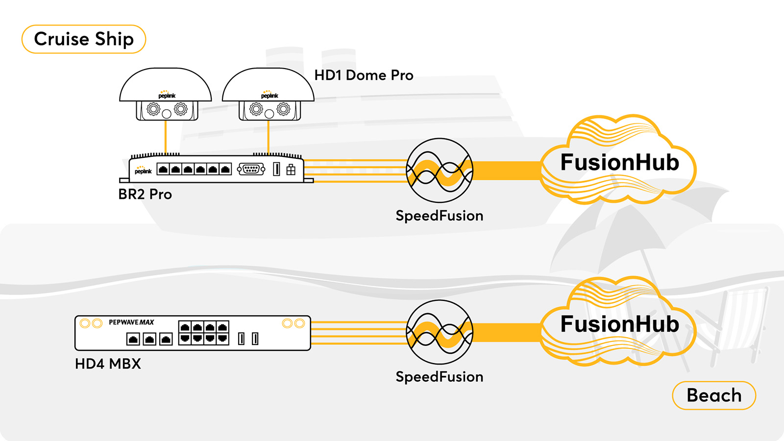

A Peplink partner was contacted and tasked with setting up the backup solution. On the ship, a BR2 Pro was installed and connected to 2 HD1 Dome Pros, resulting in 4 cellular connections. For the beachside backup solution, an HD4 MBX was set up to establish another 4 cellular links.
To avoid the need for additional hardware as an endpoint, a FusionHub was established. Both the BR2 Pro and HD4 MBX are bonded to the FusionHub through SpeedFusion Tunnels. This configuration allows both routers to leverage different SpeedFusion Technologies. Bandwidth Bonding was primarily enabled to aggregate the 4 connections both on the ship and onshore.
While conducting checks, the bonded connections ensured there was sufficient bandwidth to stream the events to the ship in high resolution. The cruise line realized that the Peplink setup proved to be more reliable than their primary Point-to-Point connection. Eventually, they decided to switch the primary and backup setups, having Peplink as the primary solution. The ship naming ceremony was a success, with simultaneous events on the ship and by the beach connected through live streams.
- Deployed to the cruise ship
- Dual 5G or cellular connections
- Bonds bandwidth together with HD1 Dome Pros
- Connected to the BR2 Pro
- Acts as additional cellular connectivity
- Enhances performance with minimal signal loss
- Installed at the beach site
- Provides up to 4 cellular links
- Aggregates all connections for one large channel
