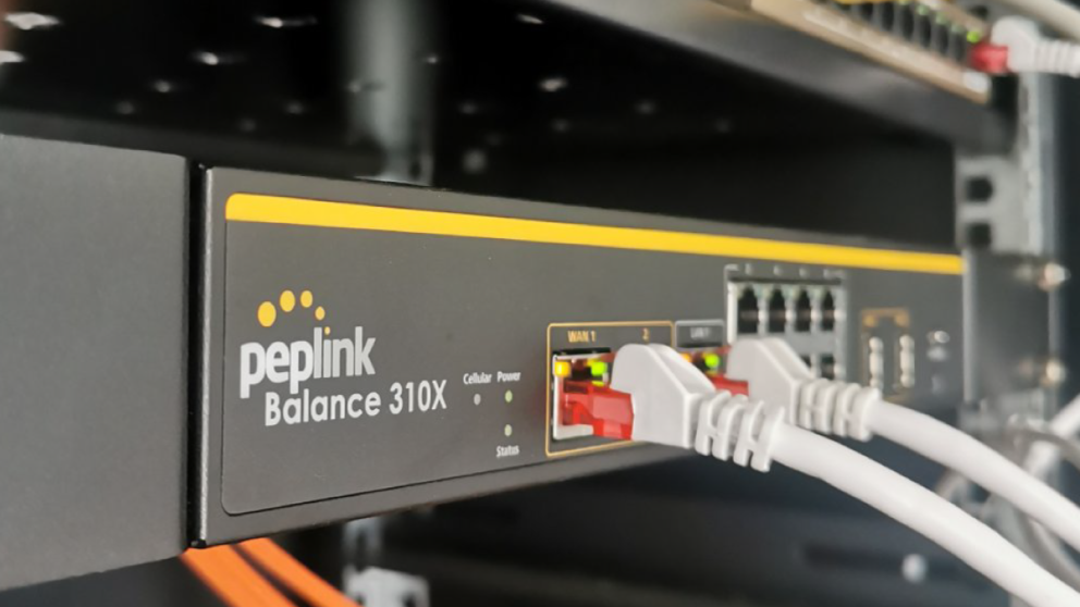

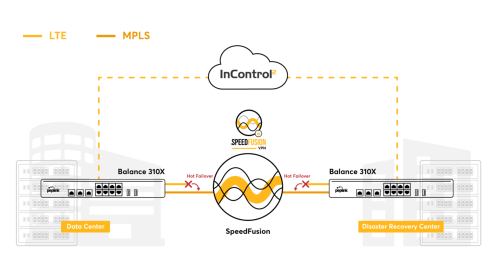

With these requirements in mind, our Peplink partner deployed a Balance 310X to the banknote company’s data center and to the disaster recovery center respectively. At each location, the Balance 310X was connected to both MPLS and LTE links. These routers are then connected to each site’s core switch.
Serving as endpoints, both devices established a SpeedFusion tunnel that enables data transmission within a secure VPN. The SpeedFusion tunnel also enabled the banknote company to take advantage of the several SpeedFusion technologies available. The entire deployment is then monitored and managed through InControl 2.
The pairing of the Balance 310X’s multi-WAN support and SpeedFusion’s Hot Failover maintained uptime by switching to the available connection when the first one disconnects. While the data transfers remained secure with SpeedFusion’s SpeedFusion VPN, WAN Smoothing improved their jittered calls using VoIP devices.
The banknote company was also able to conveniently integrate the devices into their existing network infrastructure and configured both devices through InControl 2. While in operation, they benefited from the centralized reports InControl 2 helped generate regarding any connection drops between the links.
