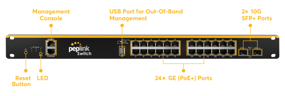

Powerful Robust Performance
High Capacity Uplinks
PoE+ Output
Out-Of-Band Management

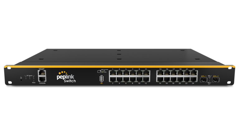

Fanless Design. Ready for Any Environment
The SD-Switch Rugged can handle -40°F (-40°C) to 149°F (65°C). The fanless design enables it to function in high-particle environments.
  • LAN Interface24x 802.3at (PoE+) GE Ports,
    2x SFP+ Ports
    VLAN GroupsYes
    Fiber Module2x 10 Gbps
    Switch Capacity88 Gbps
    Max. Packet
    Forwarding Rate
    66 Mpps
    MAC Address Table32,000
    Inter-VLAN RoutingYes
    AC AdaptorAC Input 100V-240V
    DC Output 54V*
    Power InputRedundant DC Power DIN: 54V
    Terminal Block: 12V - 54V DC
    Power
    Consumption
    50W System,
    120W PoE+ Power Budget
    (supports up to 250W * )
    Dimensions
    (L x W x H)
    10.5 x 19.1 x 1.7 inches |
    265 x 485 x 45mm
    Weight11.3 pounds |
    5.14 kg
    Operating Temperature-40° – 149°F |
    -40° – 65°C
    CertificationFCC, CE, RoHS, IC #
    EN 61000: Electromagnetic Compatibility #
    Warranty1-Year Limited Warranty
