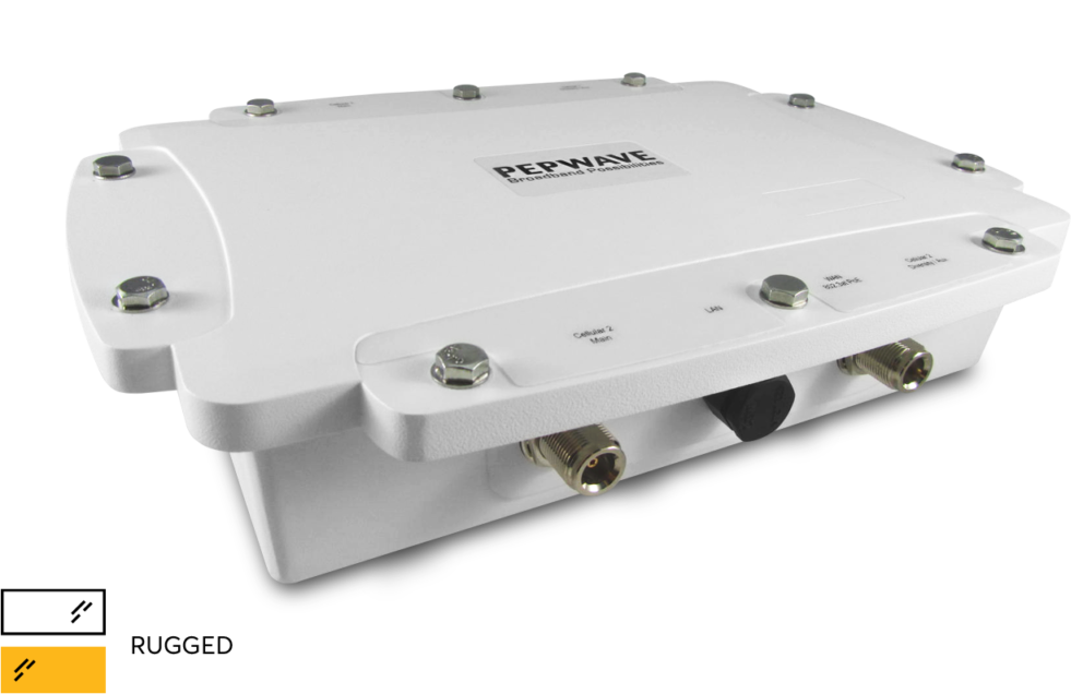

AP Pro AC
Deliver fast and reliable Wi-Fi in even the harshest conditions with the AP Pro AC . The AP Pro’s sealed, all-metal IP67 enclosure stands up to dirt, water, and extreme temperatures for years of dependable operation in industrial, public safety, transport, and other applications. Built-in PoE gives you more installation options and reduces deployment costs. And intuitive console- and cloud-based control makes configuration and maintenance simple for everyone.

Robust Carrier-Grade Enclosure
The AP Pro AC is designed and manufactured with the strictest standards. Built from rugged electronics and tough aircraft-grade aluminum enclosure to seal against water and dust, the AP Pro AC handles just about anything the factory floor, construction site, or Mother Nature can dish out. The device can also withstand temperatures from -40° to 65°C, and it’s protected against ESD and surges, so it stays up and running in conditions that would quickly shut down other access points.
