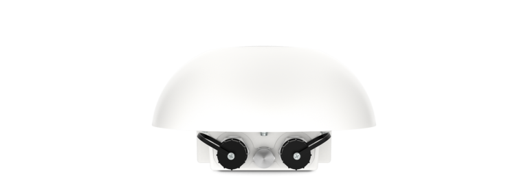

The HD1 Dome provides single-cellular Bandwidth Bonding in an IP67 enclosure that has a minimal profile on the rooftop while providing maximum signal. With redundant SIM, the HD1 Dome supports single cellular radios and two SIM cards. Combine the HD1 Dome with the SIM Injector, and the number of cards increases to ten.

Most outdoor deployments require a centrally placed router attached to strategically placed antennas. With the HD1 Dome, the antennas are placed in the same integrated enclosure as the cellular radios. This arrangement minimizes cable loss, giving you the best signal possible.

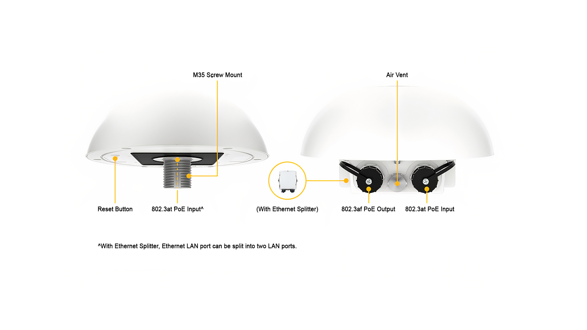

Simple Installation Running a Single Ethernet Cable
The HD1 Dome has a M35 screw mount, and only requires a single Ethernet cable to install. For wall or pole mounted deployments, the HD1 Dome comes with an Ethernet splitter and a mounting rack that provides a multitude of installation options.

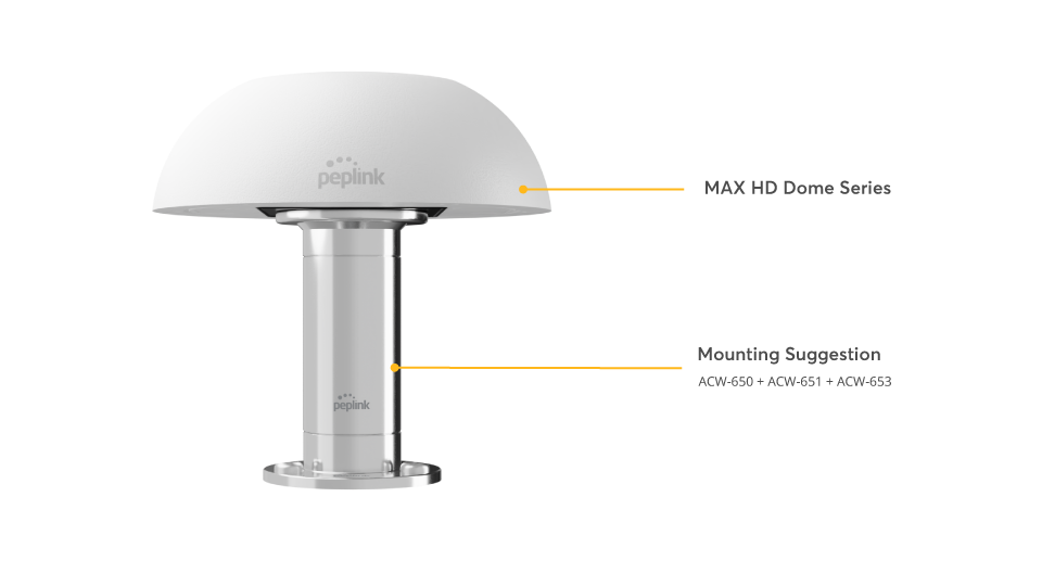

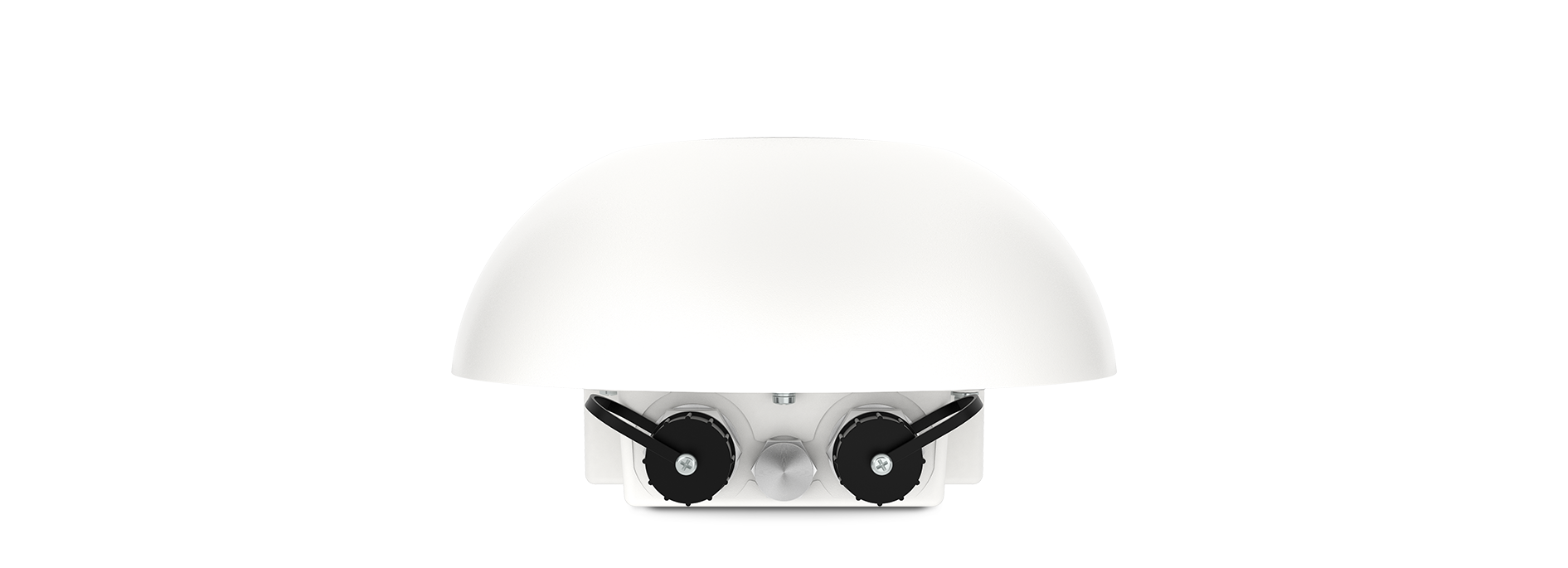

Multiple Mounting Options
The HD1 Dome offers significant deployment flexibility due to its modular construction. By itself, it has an M35 thread, making it easy to mount on top of any pole or on the rooftop of any vehicle.
The HD1 Dome comes with an Ethernet splitter that enables an additional GE LAN output. With the splitter installed, the HD2 Dome can then be used with the included mounting bracket to fix onto any wall, or to securely tie onto any pole.
The HD1 Dome, Ethernet splitter, and the mounting bracket are all included, so you can deploy this device just about anywhere.
